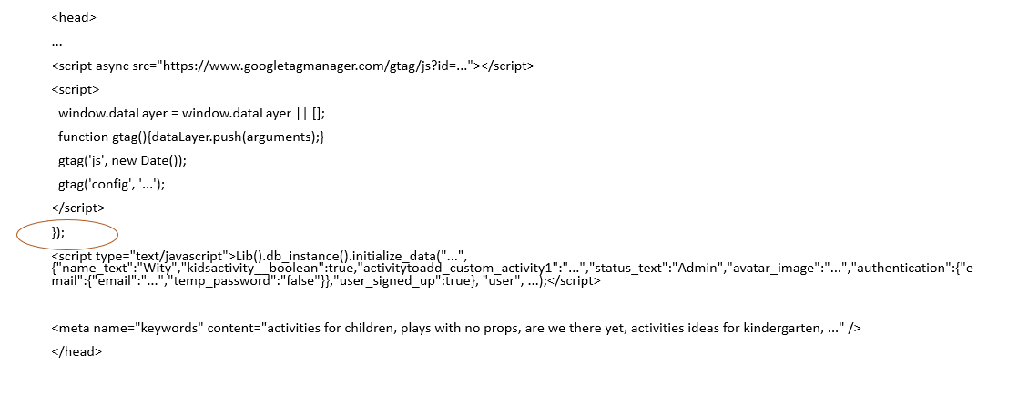

Here is a code snapshot:
UPDATE: If I uninstall the plugin Google Analytics V4 + Custom Events the issue stops. If I install it again, it starts again to show ‘});’ sign combination on page load. I have just shared it with the author of the plugin.
I don’t know why the }); is there, it’s outside of any script tags so it appears to be an error in the code, so just delete it and you should be fine.
If you can’t access the code (as it’s a plugin), then it might be easier just to add the GA script yourself and not use the plugin.
Check your page html body. I think you have a typo there.

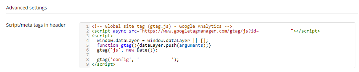

See the screengrab in the reply to @adamhholmes above - are these the fields where such typo could be?

The extra }); seems to be appearing on every page, so it’s probably in your global header for your whole app.
Check on the SEO/metatags tab in your app settings and see what’s in the ‘Spript/metatags in header’ box.

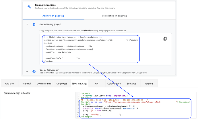

Hi @michal.kummel @adamhholmes , is this the correct way of adding Google Analytics v4 Data Streams to Bubble app header?
Thanks!
@haryanto.alvin,
not sure whether correct, but definitely viable for me.
