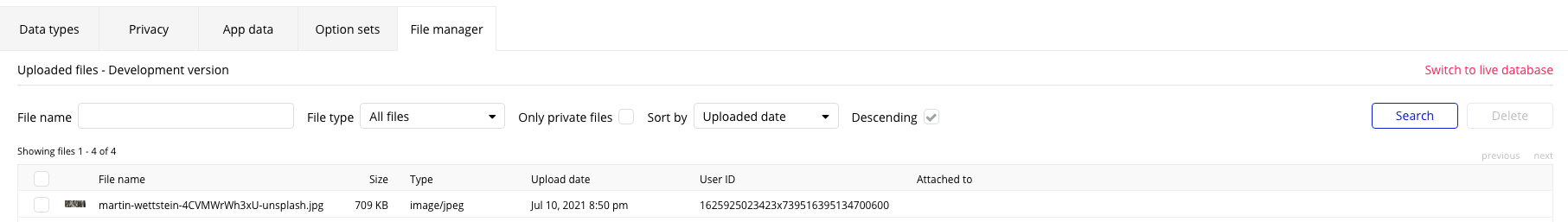

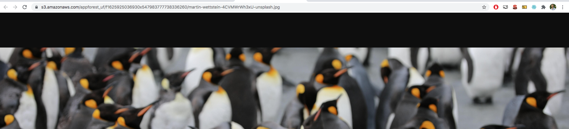

@bartek.dev I used the same approach but it didn’t work for me. Can you try if it changes the name of file in file manager for you?
I tried @bartek.dev and did not see any change to the file name in the file manager, or in the file URL

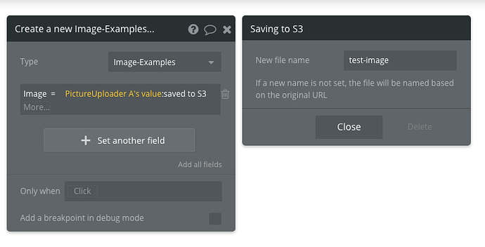

I think you have to always include file type as in name.svg, name.png etc
unfortunately you have to use regex to make dynamic text work (or am I missing something obvious?)
Regex: .[0-9a-z]+$ That will get you the file extension - works in safari
@bartek.dev I just tried that on Safari as well. It doesn’t change the name for me.
I used a png file and gave every uploaded png file a static name of ‘sumit.png’. Nothing changed in file manager.

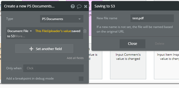

So bubble added the ability to rename files but there’s no documentation on how to do so? Frustrating! @josh
This appears like it should work, but the file name doesn’t change.

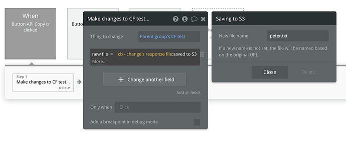

I created an API call in the app, then call that using the API connector (aka calling the original app). I get the file that way, but renaming does not seem to bite:
What am I missing?
Best, Peter
Not really sure. Looks correct setting.
Have you tried removing the .txt extension.
I did, and I tested using the same extension as the original file. No luck.
