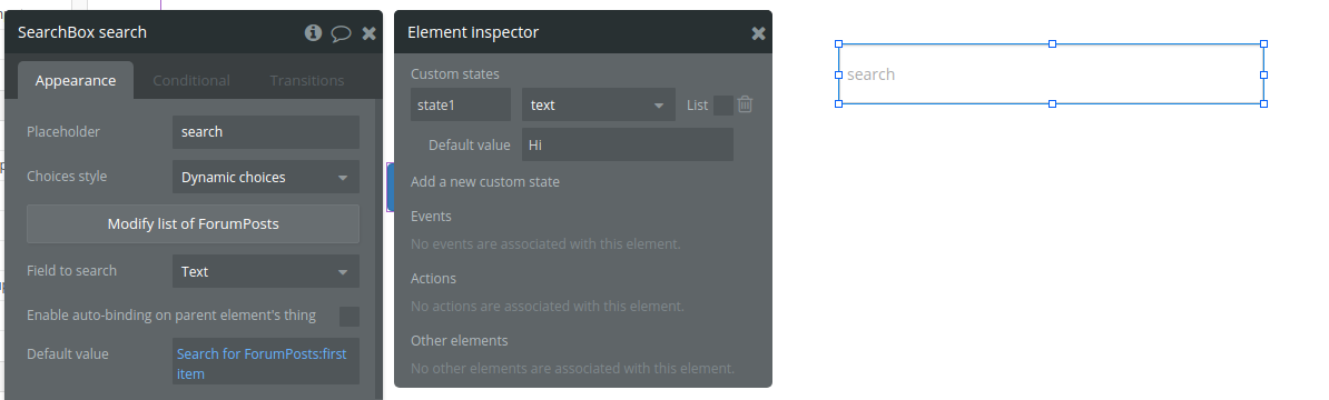

Now I tried to do the same with a search box, instead of an input box, and I can´t make it work. I tried to call the value of the custom state on the default value of the search box, but it wont accept it. I can call it on the placeholder, but I dont like it as solution.
Can this be achieved with the search box element, and it’s just I’m doing something wrong, or is it just not possible?
What can i be doing wrong?
Thanks
dynamic choices - thing element!!!
:slight_smile:
Yes. It worked! Doubt solved. Thanks for the help. :+1:
