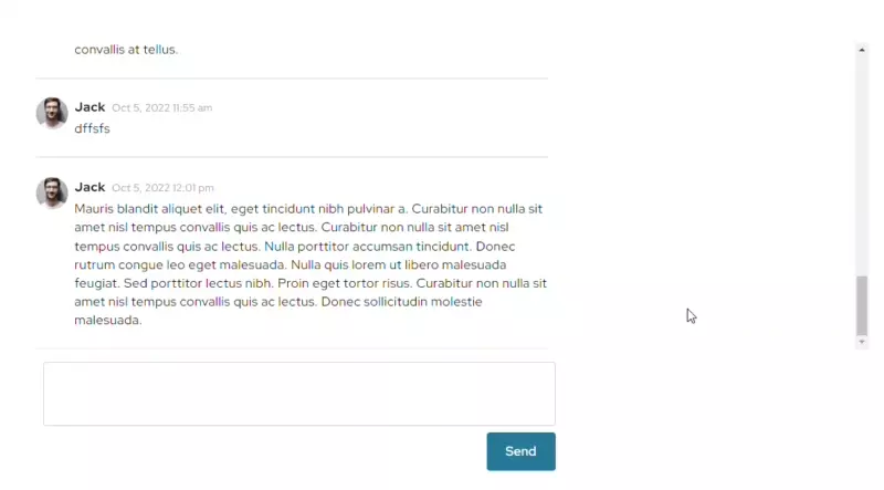

@PineappleJoe looks like the delay was due to a css scroll-behavior: smooth; that I inadvertently left on the page.
So it’s working now without the delay!
The only thing preventing it from being perfect is the non-smooth scrolling:
ezgif-5-74e7c1c6d5
At first I thought this was due to a typo in the JS (behaviour:"smooth" instead of behavior:"smooth") but changing that didn’t make a difference.
Is your scroll behaviour smooth on your machine?
Note: It’s smooth with a trackpad. It’s the mousewheel that’s the problem.
