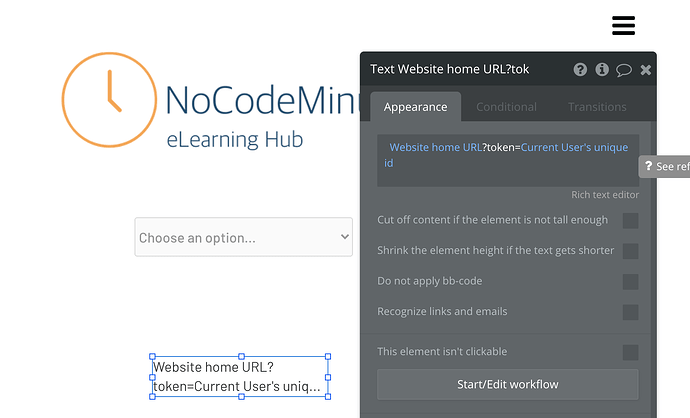

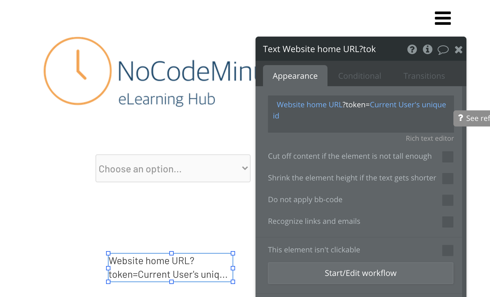

You can use dynamic data, then it will reference your URL even before deployment.

Oh ok maybe I´m wrong. Let me see if I got it straight now:
I create the referral link into a text box using the method exposed in your screenshot and that will be the link that the user will send to other people who are not signed up.
When a person who is not signed up yet clicks on this link, it will not go to error 404 because the browser will just ignore everything that is on the URL after the “?” sign.
Is that right?
RIght, I usually put the link into an input or use the AirCopy plugin to let them click on a button to copy it.

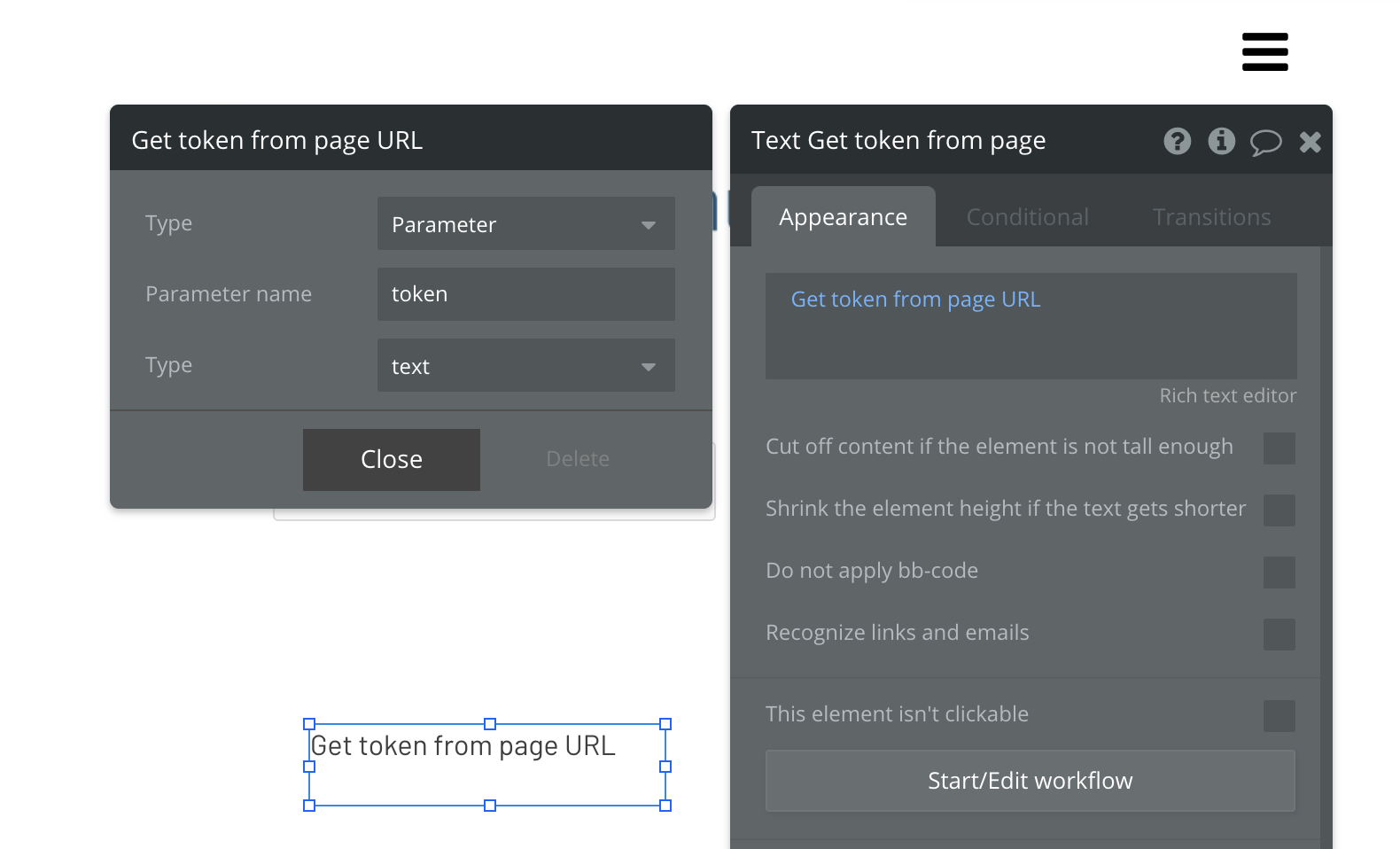

But once the user clicks on the link you will be able to access the data from the url on page load or on signup. Then when the person signs up you can attach the user referral. See image to show you how to ‘get’ the data from the URL.
Jason thank you very much! This is my second week using bubble…You were so helpful! I think I got it now. I´ll give it a try and let you know how it goes! :+1:
