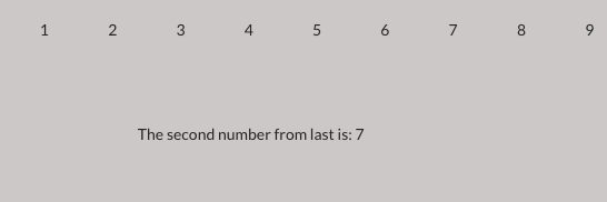

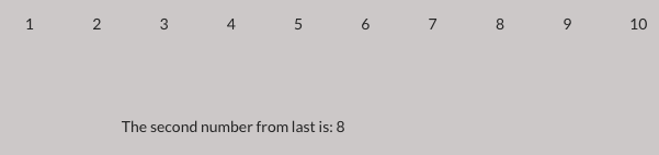

Try something like this. This might be similar to what you are looking for.
Oh OK. Then you mean the second item starting from the last one.

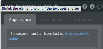

Here you are.
Use the toolbox plugin element Expression.
An expression is another way to do it. Thanks!!
