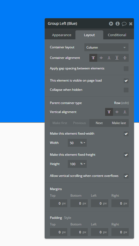

I tried to set this height to both blue and purple groups:
I also set the following setting to the parent row group of the blue and purple group:
I am not getting the desired effect.
I am not sure how to achieve that layout. Any suggestions?

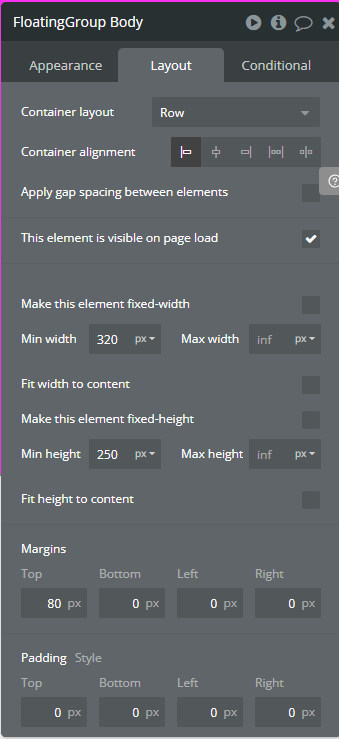

2) Using a Floating Group
Settings Group Header:
Settings FloatingGroup Body:
Note: The top margin set to 80px to display the header
Settings Group Left & Right:
Now when there is content (the grey group in the example below) with a height that exceeds the height of Group Left, this last group becomes scrollable:
chrome_CrKfC9d1Os
Hope it helps!

Ah, something went wrong when responding to you, I have adjusted my previous response. Solution 2 is using a floating group, so technically it is possible to Bubble it. :grinning:

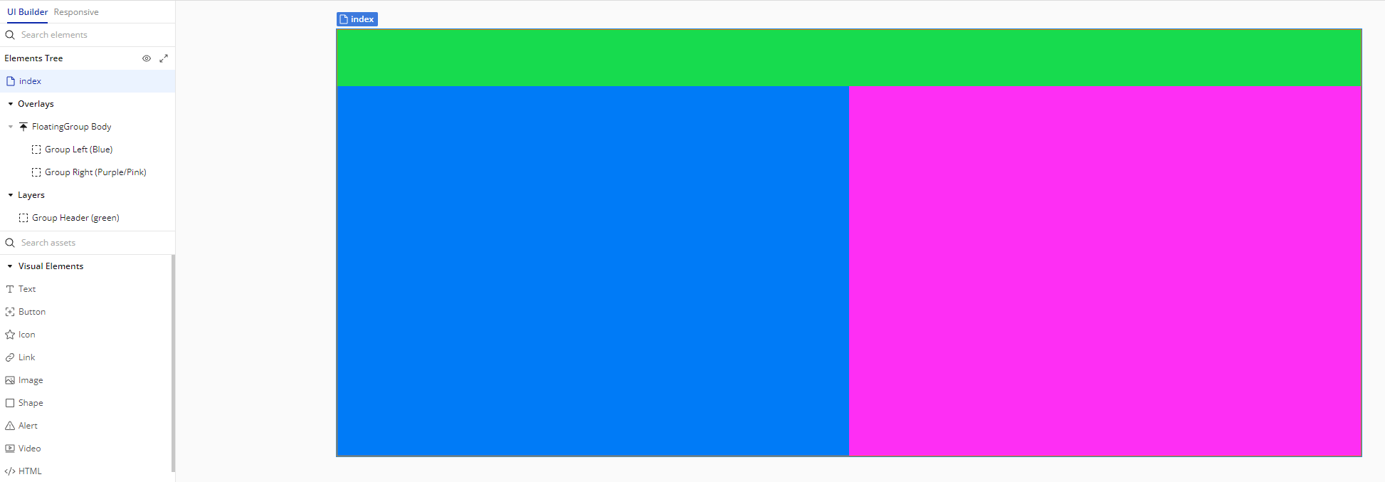

In short with the floating group:
  1. Set the page to layout column
  2. Add a group, this will be the header (green in my previous reply)
  3. Add a floating group and add left and right groups to that floating group.
See the settings for the various groups in my previous reply.
