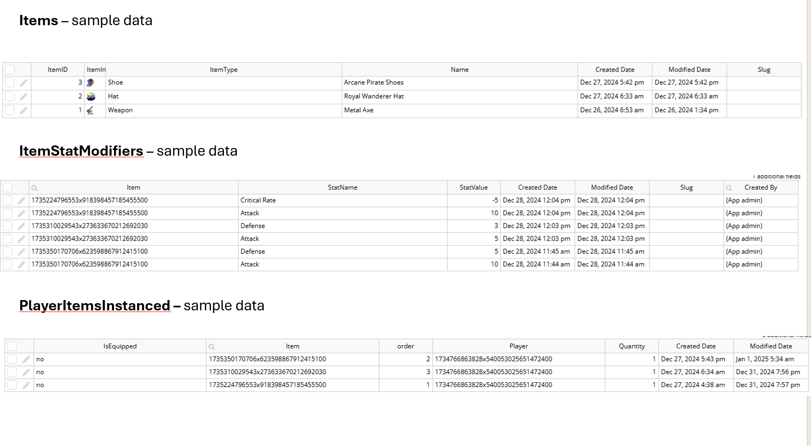

Sure, table structure and sample data as per below:
Sample data:
Also deliberating whether I should just transfer the columns from Items to PlayerItemsInstanced - someone gave me guidance on keeping them separate but somehow it feels like it just adds unnecessary complexity.
I think it is fine as is…if not a big deal to do, the best alteration is to just put an is_equipped field onto itemstatmodifiers, then it is very straightforward as Search for ItemStatModifiers is_equipped = yes and StatName=Attack each items StatValue:sum, and if you wanted to constrain by Item type you could do that too.

Create Search for ItemStatModifiers with cosntraint StatName=Attack and filter by with constraint Item is in Search for PlayerItemsInstanced constraint is_equipped=yes: each items StatValue:Sum
If it was me, I’d alter the data structure to add IsEquipped to ItemStatModifiers

Thanks - I decided to simplify by combining Items with PlayerItemsInstanced. Regarding putting IsEquipped into the StatModifier table, I decided against it in the end as 1 item can occupy multiple rows in the StatModifier (e.g., a hat adding both Attack and Defense) - which means any equip/unequip would need to modify multiple rows at once.
I also realized that order of adding constraint matters (obvious after the fact!) - if I filtered by StatName = Attack first, the query fails. But if I filtered by Item is in Search for PlayerItemsInstanced first, the query succeeds.
