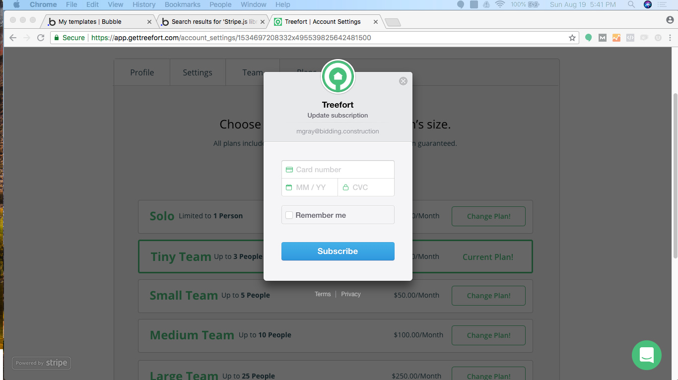

How to trigger the native stripe payment screen?
How do you trigger the native payment screen from stripe?

Thanks @dan1 how do you trigger it with bubbles plugin?

I need a simple subscription payment and I don’t mind stripes native checkout. Do you know how to trigger this in the plugin offered by bubble?
