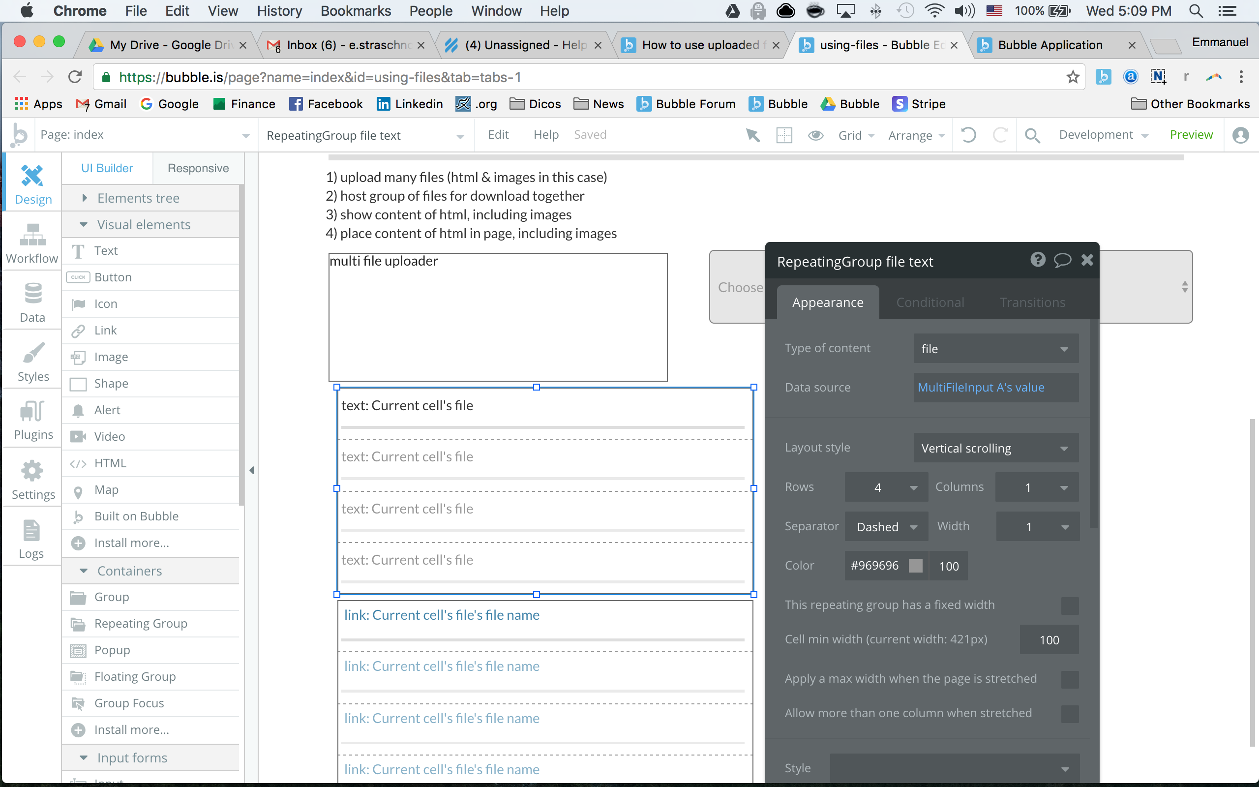

See what I did for one of the repeating groups, that gives access to each file in a list after being uploaded in the multifile uploader.

Okay, so after I select several files MultiFileInput A’s value is a list of files (correct?) that the repeating group knows to separate into individual files, one for each repeating element.
But when I tell an identical repeating group to use a thing in the database as its data source, and point it to a field that is a list of files, the repeating group lumps the whole list together as one thing. The file list doesn’t get separated into individual files, one for each repeating element.
So after I save the value of the MultiFileInput to a thing in the database, how do I address the individual files?

When I set the data source of the repeating group to a list of files then the text field in each group can easily be set to “current cell’s file” which seems like exactly how it should work. The repeating group should accept a list of files and put one file into each cell.
When I change the text field from “current cell’s file” (which dumps the whole list of files) to “current cell’s file’s filename” it does display the file name correctly (instead of the whole list of files) but ONLY in the first cell of the repeating group. It doesn’t show any of the other files in the list.
