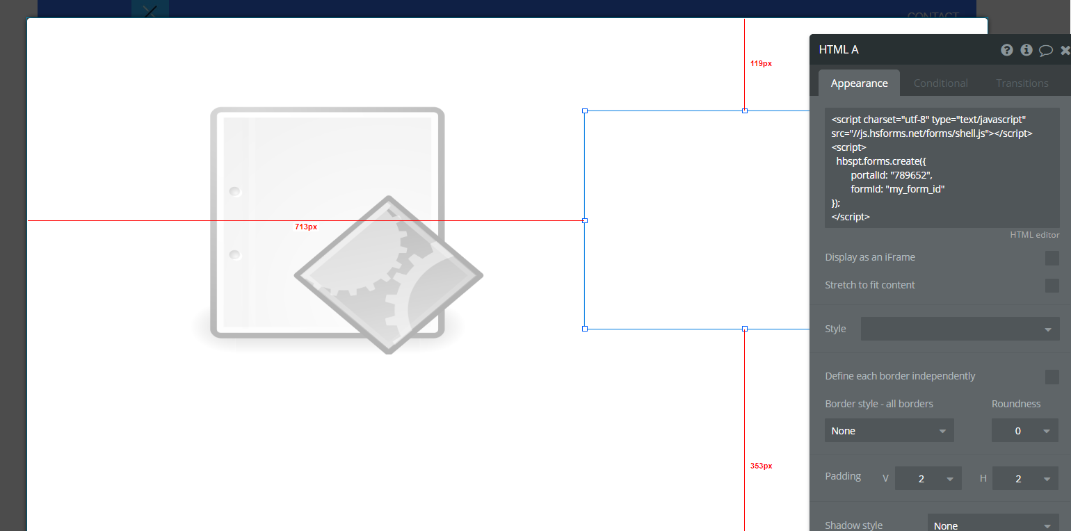

I want to embed my Hubspot form in my bubble app. Basically the user clicks a button, a popup appears. the user fill out the form and the contact is added to my database.
I tried to pasted my HUbspot form code in abubble to JS field and a HTML field but it does ot work.
Can someone help me on this ?

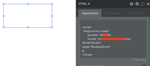

Hey @jv.hirigoyen!
Here is how I was able to get a Hubspot form to display on a Bubble page.
On the page itself, insert the source code link provided by Hubspot into the page html header:
Create a group on the page where you want the form to display, and give it an element ID:
In an html element, use the code provided by Hubspot for embedding, and add an additional parameter of “target”. The value of the target parameter should equal the element ID of the display group element:
The html element can be very small as it will not actually display the form, it will only load the script.

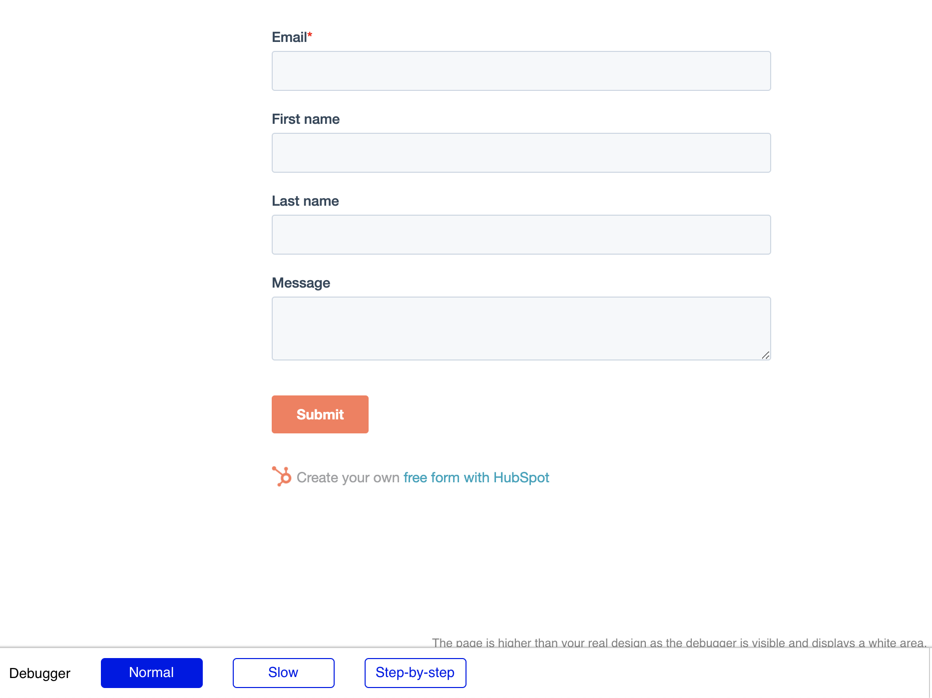

I did one quick test and it submitted just fine:
That should get you going!
–Ken
