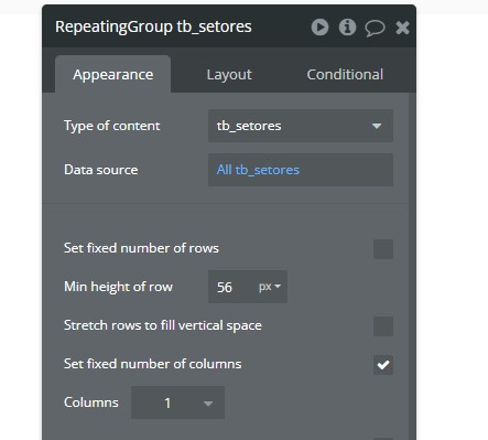

Hello, @jacob4930! How are you? You need to execute what I sent you in print, test it and do it on your website, it will work, but then you need to test the sizes. But the main idea is to remove the fixed number of lines.
Thanks a lot for your help :pray: Now I finally made it work like I want it too. So great that it doesnt have to load the entire list but loads more games as the user scrolls down. You’re awesome :hugs:
Glad it worked @jacob4930! Glad I could help.
