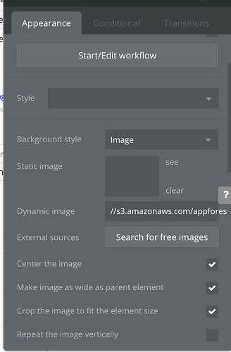

@andrewgassen I have a group and the group background style is an image. The file i’m trying to upload is an svg image from my desktop. To upload the image i’m clicking on static image which prompts me to select the file

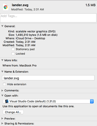

it shows up in a web browser but not the editor or preview. Here is a screen shot of the image details
Interesting. I’ve never tried using an svg as a group background. I’ll experiment a bit and see if I can reproduce. Also, have you tried a different svg to see if it has the same behavior?

Hi @calvin1 I just tried it with an SVG as the image background of a group. It worked without any issues for me. I’m using latest version of Chrome, tested on Macbook Pro and Windows 10
