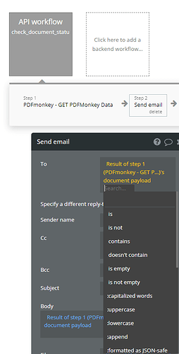

If anybody wonders here is my email-filtering with the helpt of adamhholmes:
step11
