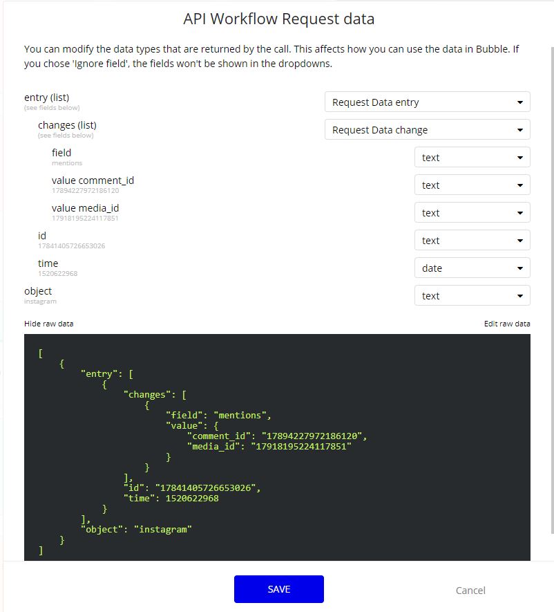

  1. The Bubble endpoint is setup and the Detect Response Data function seems to have worked as expected. When we click the Modify Types button, the API Workflow Request Data definition is exactly as defined by the Facebook reference documentation.

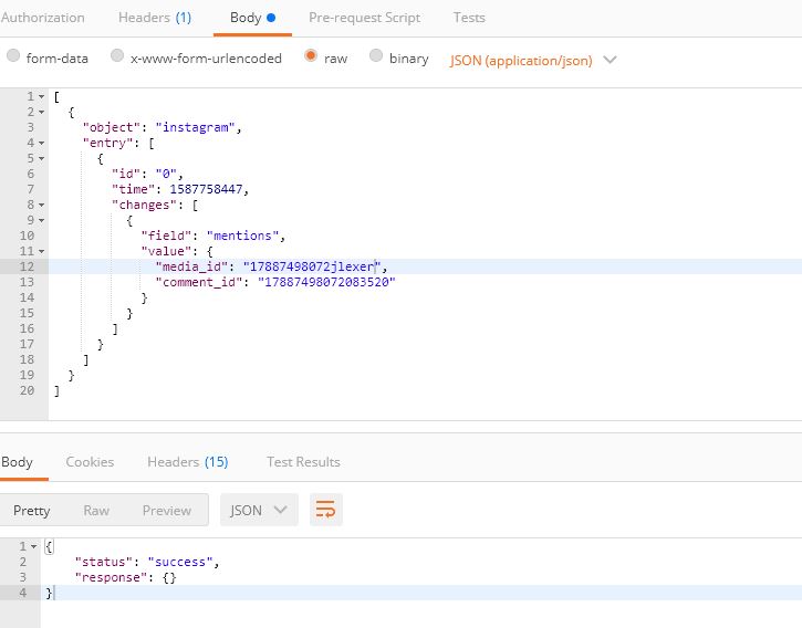

  2. When we send a Postman test of the response data to our Bubble enddpoint, it is received just fine.

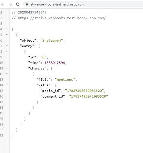

  3. Given the data is received correctly by our Bubble endpoint via a Postman test, it would follow that there is something off with the Facebook console test function …or that would seem logical. To test this, Facebook provides a sample app that can be deployed on Heroku for the simple purpose of seeing the webhook response. We did this, and found that the Facebook test data was exactly the same as when we did a Postman test.
