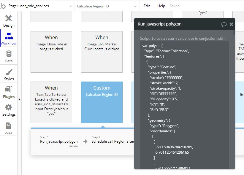

Now you can run this java script function how ever you like. (i had to reuse mine so its in a custom event. but in the work flow you select run plugin and select “Run JavaScript”
then you just copy the code provided below in the same format below.
The code:---------------

function isPointInPoly(point, poly, itemNum) {
var x = point[0], y = point[1];
var inside = false;
for (var i = 0, j = poly[‘features’][itemNum][‘geometry’][‘coordinates’][0].length - 1; i < poly[‘features’][itemNum][‘geometry’][‘coordinates’][0].length; j = i++) {
var xi = poly[‘features’][itemNum][‘geometry’][‘coordinates’][0][i][0], yi = poly[‘features’][itemNum][‘geometry’][‘coordinates’][0][i][1];
var xj = poly[‘features’][itemNum][‘geometry’][‘coordinates’][0][j][0], yj = poly[‘features’][itemNum][‘geometry’][‘coordinates’][0][j][1];
var intersect = ((yi > y) != (yj > y))
&& (x < (xj - xi) * (y - yi) / (yj - yi) + xi);
if (intersect) inside = !inside;
return inside;
var currentLocation = [Dynamic Val Goes Here]
for (var i = 0, j = polys[‘features’].length; i < j; i++) {
result = isPointInPoly(currentLocation ,polys, i)
if (result == true) {
bubble_fn_RegionPolySearch(polys[‘features’][i][‘properties’][‘R#’])
break
cODE ENDES HERE:------------

now you add an element to your bubble page called JavascriptToBubble.
i think the highlighted part speaks for it self. so remember the text that you appended to the “bubble_fn_” you have to use that back here. its CASE SENSITIVE. so for my example its “bubble_fn_RegionPolySearch” so i use “RegionPolySearch”
just make sure those boxes are ticked and know what kind of element you want returned. originally i wanted to return an Integer but i had a few probs with it, you can play round with that if you like. but i ultimately choose to return a text.
now for the last step. FINALLY!!!
you need to run a work flow to retreive the javascript value, but thers a trick to it.
so you just have to point to the value of the javascript to bubble element that you added to the page. But the value wont publish until the javascript has already run completely.
so currently i have a little over 20 regions.which covers 35 miles, i need to prob double that to get the total amount of regions i need for my app. and with the current regions a device takes about 3-4 seconds to calculate the current region. so you need to wait that long befor trying to publish the value in the new workflow.
Annnnnnnd youre done.
this is the longest post ive ever made… you better use my solution yo.
but with this you have an idea as to how to do stuff from the java script side, you can prob run this work flow from the backend for a faster result and to freeup device resources but of course you would have to end up paying for the resource power. i just put up a loading screen when doing my calculations, and i also noticed that some devices take longer than5 secs, so i create a work flow that auto runs when a page state is empty called Error Auto fix, so the common user thinks magic is happening in the background when its just me giving the work flow time to run properly.
