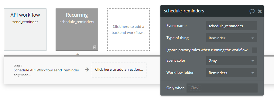

2. ‘schedule_reminders’ (backend recurring event)
What we’re doing here is just defining the event that needs to be triggered on a daily basis.
It has one action which is to use schedule that API workflow we already have set up ‘send_reminder’.
We schedule this to go on the current day at the right time specified in the reminder and we also request that it only fires if the indexes contain the current days index as shown above.

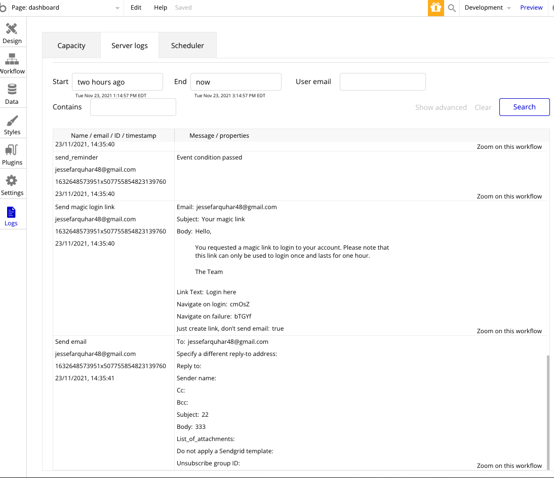

Hey, i have set up as you have detailed but didn’t get an email at the time the use (myself) selected.
I don’t know what the problem is so i don’t know if these two images will help reveal anything or not.

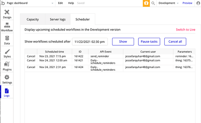

Unfortunately it’s not working still, i changed it to start today and set a new reminder for 2:35 but didn’t get an email. I wonder what’s going wrong.
Hmmm, that’s unusual - can you include a screenshot of the row in your table that has the reminder scheduled for 2:35pm?
Looks to me from above that you have a reminder scheduled to send at 7:15pm which makes me think that the recurring event is working correctly, but there’s just an issue with the actual sending of the reminder email.

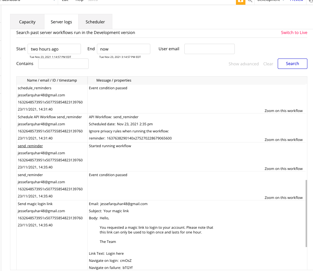

What do you have in your server logs around 2:35pm? Any errors?
Okay perfect, so the workflow is definitely working as expected, it just seems that the email isn’t coming through to you.
Might want to check your junk email folder to make sure it hasn’t got lost there but it seems like it’s working as expected.

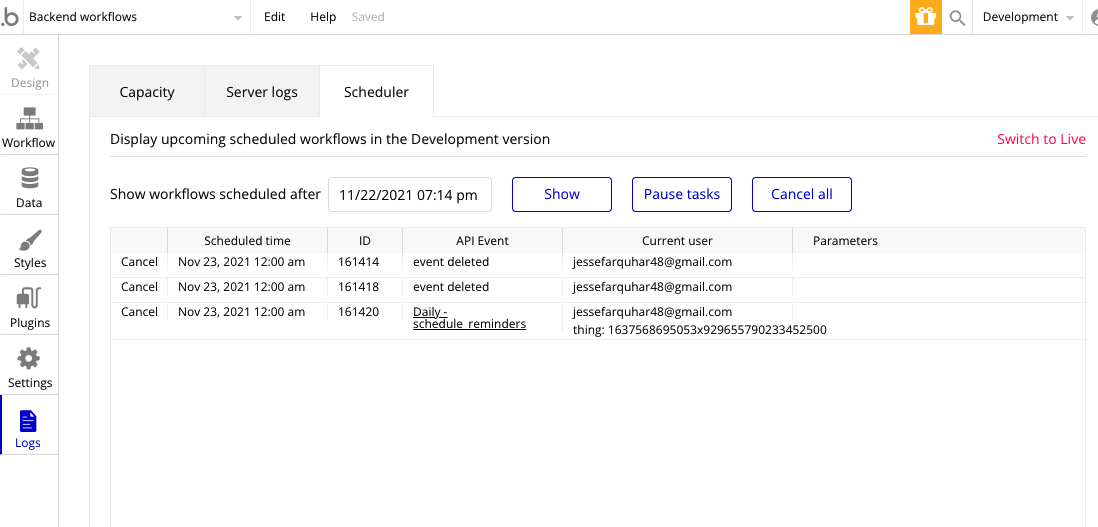

  1. It seems that the schedular is showing/still running any prior schedules when it instead should updated itself so that it only ever has one active per user (e.g. if they sent another one). It looks they might be going to 'stack each time (which is not desired).

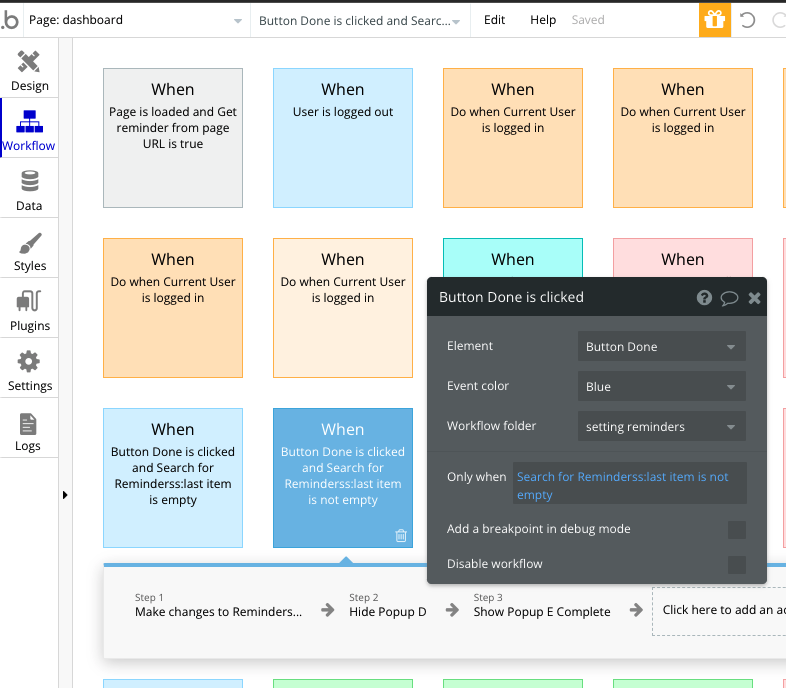

  2. (may be related to the first point above) I have set another workflow on the dashboard page (an alternative version of the initial one) to make it so that the database is updated with a new ‘reminder’ when they want to set a different one but i’m unsure if this will work properly (e.g. still schedule a new reminder) the way i’ve set it up. There should only ever be one row in the database for each user. take a look at the workflow, it works in that it modifies the users entry with new time/ days of week. i’m just asking if this will still schedule/modify the scheduled reminder.

Yeah I reckon it probably is. You definitely only want to keep one reminder row per user. If you create multiple, then you will definitely ‘stack’ recurring events on the same person.
Seems like you’re already on the right track, but basically if they click done and a reminder already exists, you just want to make a change to that reminder and close the popup, that’s it. There’s no change required to the recurring event.
Only if the reminder doesn’t exist do you want to go about setting the recurring event.

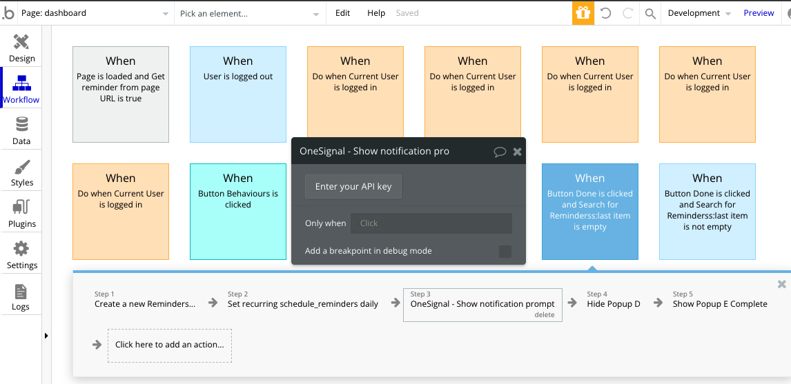

Yep cool - so you’ll definitely need to add the ‘Show notification prompt’ action to this workflow so that the user can give permission. You should do some thinking about what the ideal user experience is and then work on building that.

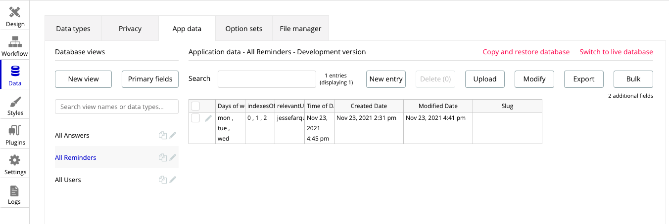

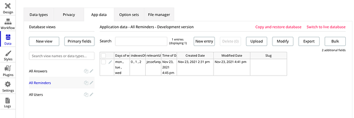

I updated the DB entry (via using the front end). to make a 4:45 pm ‘time of day’ reminder.
…But the scheduler still shows the old one that was set for a 2:25 time. It see that the workflow for the scheduler is only being informed if i delete the database an start again… i.e. if the ‘create new entry only if empty’ workflow runs rather than the 'modify thing, only if reminder isn’t empty
The recurring event runs daily and so is therefore only scheduling ‘send_reminder’ for that day. If someone has a reminder scheduled for 3pm but at 10am goes in and modifies their reminders so it sends at 1pm, then yes you’ll have a bit of an issue on that specific day because the notification will come at 3pm instead of 1pm. However the next day, it will come at 1pm as expected.
Two solves; (a) either inform the user that the ‘changes will take effect from tomorrow’, or (b) you can make an adjustment to the recurring event so that it has a second action which saves the scheduled workflow ID against the reminder so that you can delete it if you need to.
This does however add more complexity because you also need to tackle the setting of any reminders due the day of the change. In the same example above, when you make the change at 10am, we could delete the 3pm notification but you’ll need to wait until 12am the next morning when the recurring event runs again to realise it needs to schedule an event for 1pm.
I’d probably recommend the first solve as an MVP approach and if you feel the need, you can iterate on it later and build more robust functionality.

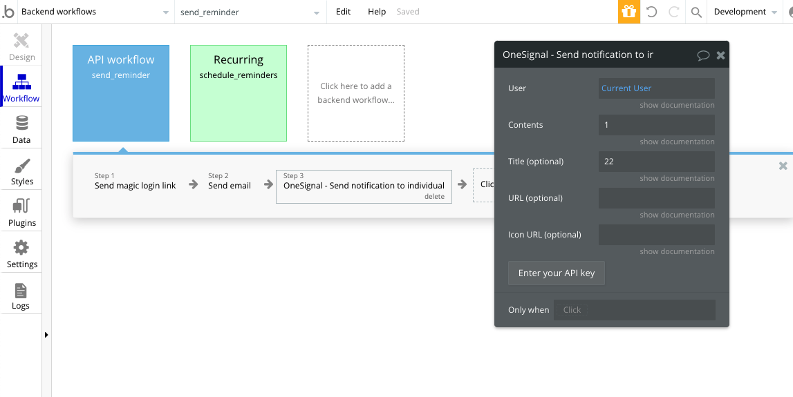

Onto the One Signal situation. Here’s what i’ve done:
It didn’t work (even though i wiped the database and scheduler beforehand to start from scratch. I don’t know what i’m doing on this one.
