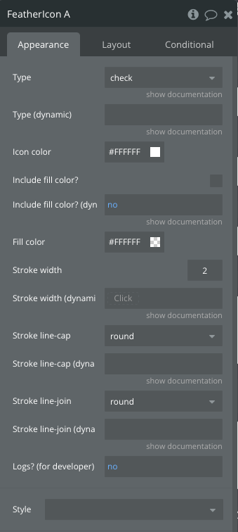

I personally uninstalled the ionic plugin a little while ago as it does have some restrictions like this, but also loads like 1mb of code into each page which is huge for what it needs to do. It basically loads a whole component library for just a few things.
It’s actually super easy to recreate this just using a group and a check icon package like feather icons.

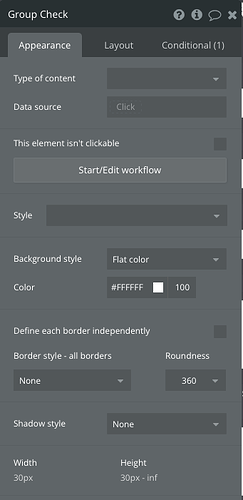

This is my circular group - not the roundness of the border
There's a state on the parent group (yes/no) which captures whether it's checked or not
Screen Shot 2022-05-05 at 2.58.13 pm
I have a check icon in the middle

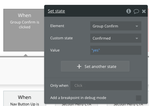

When the user clicks the group I change the state to YES and the background turns green
Screen Shot 2022-05-05 at 2.59.04 pm
In this case I only need the user to click to confirm and then they don’t need to uncheck. But similarly I could add another workflow that sets the state to no if they click it when the current state is yes
Hope this helps. You then have all the freedom to do what you want after that cos it’s just a standard group you’re working with

Hi Josh, thank you! I really have a problem with the last one, though.
I just don’t understand, what do I have to do to invert this process. Could you please point me in the right direction? I’m trying to make check/uncheck icon, like in a task manager
So you need two workflows “When Group Confirm is clicked”
  1. Only when Group Confirm Confirmed is YES
  2. Only when Group Confirm Confirmed is NO
For the first one, you then set the state to NO in an action on that workflow, and YES on the other.
Basically when the state is YES, make it NO & when the state is NO, make it YES

I finally got, thank you! Took multiple tries, but I suppose I messed up something, because as soon as I built the whole page from scratch, it all worked!
