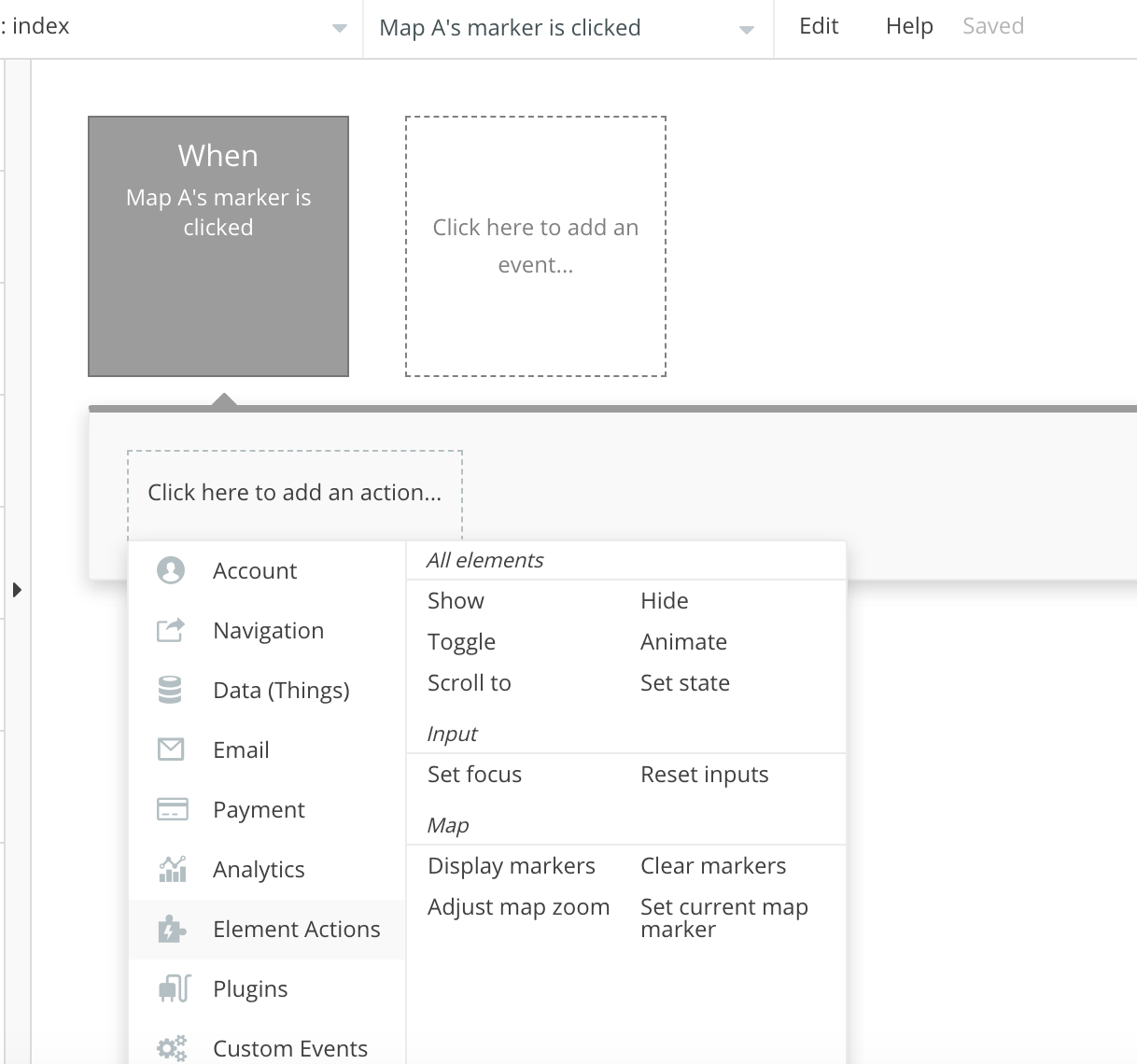

Hi @hhmiles3 :slight_smile: There is! (This option will show up once a map element is on the page where you are adding this workflow)

If you trigger a workflow using “…marker is clicked” then the thing attached to the marker is available as “This Map’s Current Marker” in your workflow.
So I have a map with a list of locations as the marker source. When someone clicks a marker I pull the name of the location that was clicked (it is not unique) and search for all locations called that and display them in a repeating group.

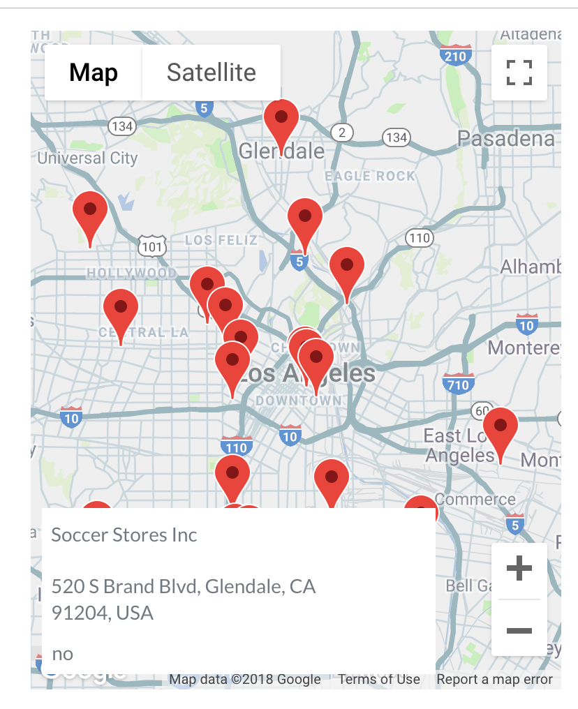

Hi @NigelG I was able to create the group and have it display the location details once the market is clicked, but is there a way to hide it and only display when the market is clicked? I would also like the group box to display just above the marker. Is there a setting I can change to have it appear right above the marker when the marker is clicked? This is what I currently have.
