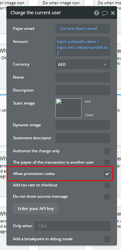

Issue with Stripe plugin. Promotional code not working on checkout. Action "Charge the current user"
Promotion codes during checkout are not working.
The checkbox that allows to use them is checked.

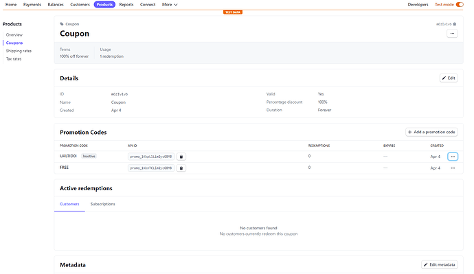

I set up the promo codes on Stripe Dashboard, and they’re not working both on test and live modes.

I’ve noticed that with promo code, you can’t do 100% off. I’m not sure why, maybe @tj-bubble can help answer that?
Hi @johnny, just checked it, you’re right. It works with 90% discount.
But the point is that I need 100% discount for testing purposes, to test live payments.
Don’t you know any possibility to test live payments in Stripe? Without actually spending money from your card :sweat_smile:
