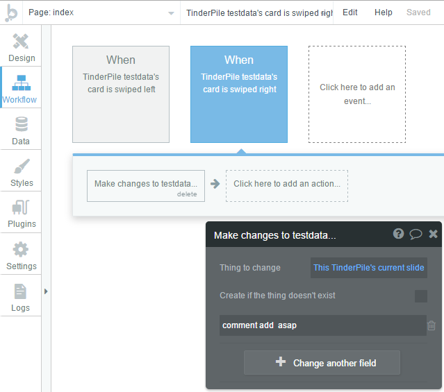

  • I included a constraint in the search for the tinderbox
  • I have a workflow, that upon tinder card swipe makes changes to the current tinder card
  • After the first tinder card swipe, I have a missmatch in what the tinder pile shows and what “thisTinderPile’s CurrentCard” is returning as a result. This is shown here, the textbox on the right is showing the result of “this TinderPile Current Card Description”. It should match with the tinder pile, but it does not.

Hello
Check if you have two workflows that are running at the same time when doing an action with the tinder current card.
Usually this happens because you have a workflow with actions that activates a button that swipes the card to the right or the left, and then you also have a separate workflow with the same actions when the card is manually swiped.
This causes that the app run the two workflows at the same time, which may cause the mismatch of the card given and the card wanted.
The proper set up should be:
  1. Workflow condition —> when this button is clicked: Action —> Swipe card to the right
  2. Workflow condition —> when card is swipe to the right: Action —> Group of actions you want to activate for the current card.
do not duplicate the actions in the first workflow, you only need them in the second workflow. that way will work when the user clicks the button and when manually swipes the card.
Hope it helps :slight_smile:
