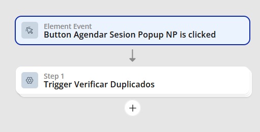

  1. Button Clicked → Triggers “Check for Duplicates”.
  2. Custom Event: “Check for Duplicates”
  • If a duplicate is found (count > 0), show an error and terminate workflow.
  • If no duplicate is found, trigger “Check for Overlaps”.

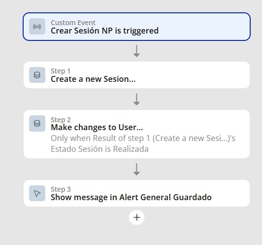

  1. Custom Event: “Create Session”
  • Only executes if called from “Check for Overlaps”.
  • Creates the session and shows a success message.

Conditions to execute the Terminate this workflow actions and those for invoking Custom Events (CEs) are mutually exclusive, so the fact that the process keeps invoking the next CE is not in contradiction with the Terminate this workflow actions not being executed.
The problem here seems to be that the invocation of CEs is apparently firing when it shouldn’t. So, we should have a look at the conditional allowing to invoke the CEs.
Can you confirm that the condition evaluates to something you don’t expect?
I’d recommend going through the debugger step-by-step and checking those conditions which are failing to trigger the terminate action

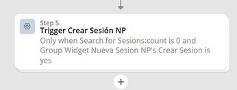

What are the search parameters on this action? It could be that this action is failing to set it to yes
Search for Sessions:count is 0
If I understand, you have the same condition here, it could be either your Search for Sessions:count is 0 is not set up properly, or your Group Widget Nueva sesion NP's Crear Sesion is yes is actually no

Weird thing. What should these Verificar Duplicados and Verificar Solapadas CEs conditions evaluate to when the bug happens? True or false?
  • Only when Search for Sesions:count > 0
  • Only when Search for Sesions:count is 0

The ‘Set State’ is not changing nothing, actually. If I delete it, it will run the same way. I just put it in order to add another conditional, but it does not works.
The problem is when there is the action “Create a Session”. When I put it, it will be created before anything else.

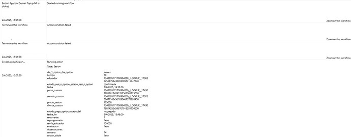

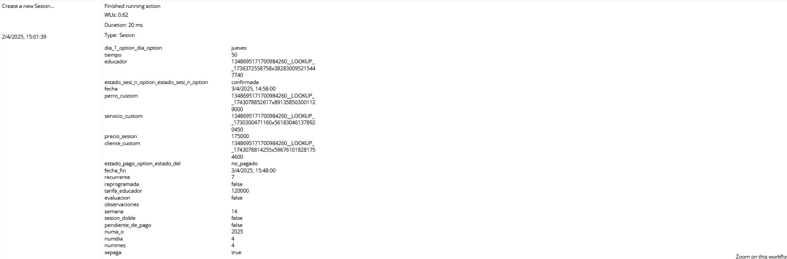

Video where you can see the Step by Step and the premature creation of the session.
Sorry, but I did not understand exactly how to do that.
In case it is useful, I did a video where you can see how the session is created before anything else. If not, could you explain me exactly what to do, please? Thanks!
Video - Step by Step and the premature creation of the session.

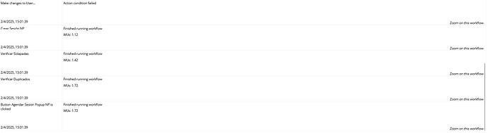

Definitely looks odd, I would go back through your server logs from 3:00-3:02 and see what action triggered to create the item in the DB, it could be firing from another action that’s not included in your custom event, otherwise it might be a bug.
This is a weird behaviour of the debugger, I’ve seen it before.
But I see no bug in your execution, the Sesion gets created because there is no duplicated Sesion in DB.
If you try executing it again an a second exact Sesion gets created, then it’s a bug.
But that weird execution is triggering the alerts. Then when someone is creating a session, always will appear the alert “That session was not created because is a duplicate”.

I looked and I think there’s something weird. I am not used to look at the logs, but it starts with the “terminate this workflow” conditions:
Same problem running normal.
