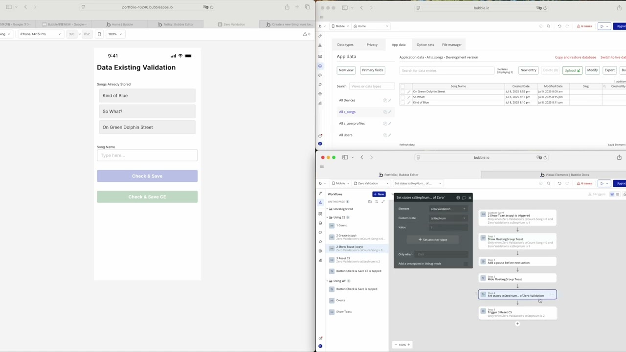

Hello.
I want to create a workflow where, if an input value is already registered, an alert is shown, and if it is not registered, the value is added. However, in cases where the value is not registered, the “Create a new thing” action fires before the :count check, so both the registration happens and the alert is shown—this is the issue I’m experiencing.
I believe this is similar to the issue discussed here:
According to advice from the Bubble.io Bug Report chatbot, it suggested saving the count value to the database and referencing that value via “Result of Step” as a condition for “Create a new thing.” Is this… for real?
I’ve summarized my issue in a video. The Custom Event refers to the return value of the previous CE.
How do you all handle this situation?
Thaks!

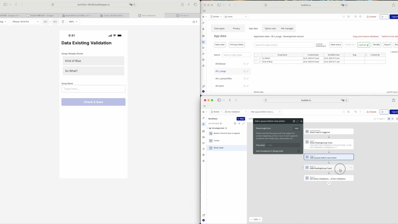

Hello @ahmed.elkaffas ,
Thank you very much for your kind reply. I tried your suggestions and created a video to demonstrate the results.
1 & 2 – As you advised, I set up the workflow triggered by the “Button Check & Save” so that it includes only one “Trigger a custom event” action.
However, the result remains the same: the “Create a new thing” action is still being executed before anything else. Do you think I have implemented it exactly as you described?
Lastly, in the video, I used the word “misfired,” but considering that Bubble workflows are not guaranteed to execute strictly in order, I realize now that it may not have been the most accurate term. Still, I would really like to find a way to ensure that the count action is executed first and controls the sequence.
If you have any further advice or see something I might have missed, I would appreciate your input.
Thanks,
Hi @ahmed.elkaffas and all,
I conducted the above test using the “Mobile app” and checked the results with the “Web debugger” (as shown in the video). However, this may have been a mistake.
When I tested it with Bubble Go, I found that registration and the alert did not fire simultaneously, and everything worked as expected. It seems that both the blue button created with WF and the green button created with CE are functioning properly. Sorry for the mess.
I’m planning to run the same experiment using the Web Builder as well.
Thanks,

Hi! I see they gave you the same answers that they gave me in my post. I think it is a bug that happens to few people.
The solution I found useful is to add the action “schedule a custom event”. That way it works fine.
