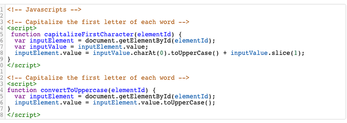

I have an input field with ID: inputField1 and I am running a workflow on value change to run a javascript.
The javascript modifies the value of the first word to uppercase. The javascript is saved in the body from setting and calling from workflow with the variable as the input field’s ID.

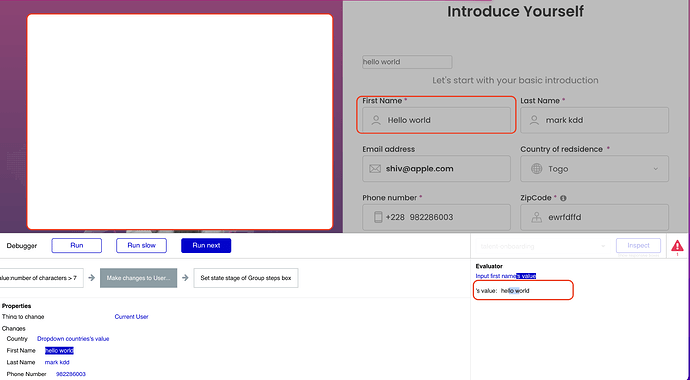

Everything works and the modified value is displayed in the input field but when I save the modified value (uppercase), the modified value is not saved.
That’s because you are manipulating the DOM, not the app. The data of the input is stored I. The memory managed by the app after each keystroke. Since you change the value of the input via JavaScript, the app doesn’t realize it’s updated and therefore it’s value is not realized during the save.
When you save the record, the app isn’t pulling the value from the input directly, rather it pulls it from a variable saved in the app itself that gets updated when the input is updated by a user, not code as you have done.
