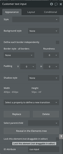

  1. changed app settings in the app to expose the option to add an ID attribute to HTML elements
  1. added an ID attribute to a rich text editor

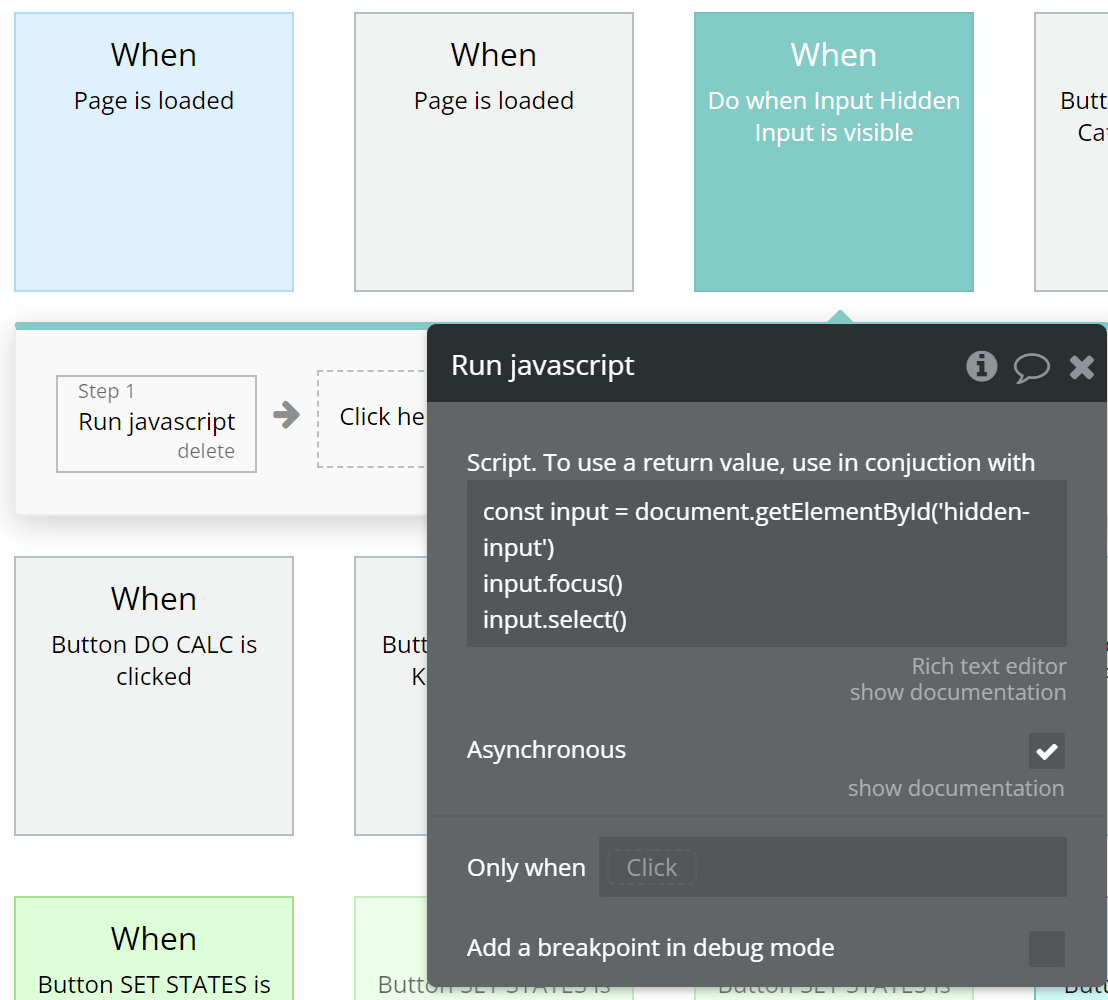

So, I’m not sure how what you’re doing is really different from just setting the input’s focus when it’s visible:
If you really want to set the initial content to be selected, like I was saying, you just fire the script when the input becomes visible:
… but if you did want to execute some script on page load that waits for an input and then, whenever it first shows up on the page, set focus to it and select its contents, you could run the following script in a Run JavaScript action.
What this does is uses a mutation observer to watch for the element specified with selector (which should be a CSS selector - in this case an ID selector which is a string like '#element-id', so in your case you called your element ‘cus-input’, so the selector for it would be '#cus-input'). In my example code below, my element is called ‘#hidden-input’ (so you’d replace that with your input’s ID.
The first part of the code defines the function waitForElement and then in the last line, we call that function. It waits until the specified element appears in the page and executes the code in the .then() clause (which here just calls the element’s .focus() and .select() methods.
Here’s the code - you’d trigger this on the Page Loaded event:
