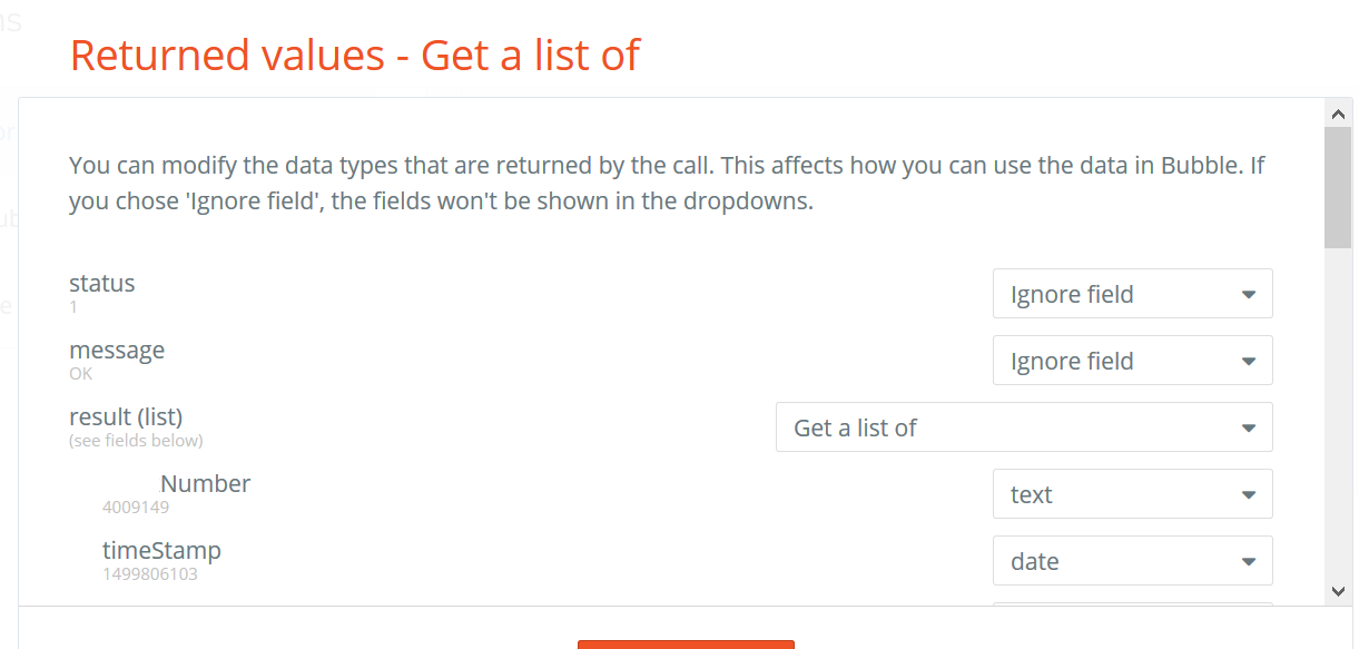

I’ve created an API get call which returns a json but when I create a data thing, it gives me all the rows together, not a list of rows.
How’s the way to get a list of different items instead of one single row with all the items in it?
Thanks very much.
To provide more information, this is the return values I get:

I basically display the results directly into a repeating group without creating a thing (table) first.
Creating a thing (table) with the API results is what didn’t separate the different rows from the json list.
So:
  • I create a workflow triggered with the user’s input.
  • I create an action: plugin > API call (previously configured with the API connector plugin).
  • I created a repeating group in the design section.
  • I create an action: element actions > display repeating group (select the repeating group created in the previous step).
  • I create a visual element > text within the repating group and then select the field of the json result.
And that’s it.
Hope it helps.
