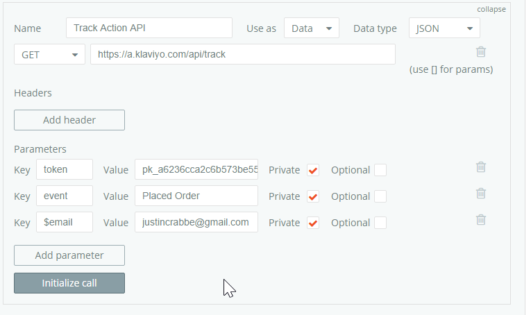

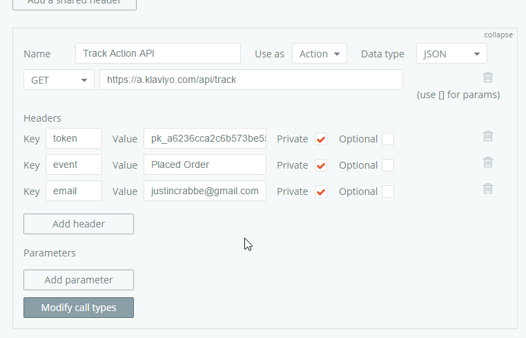

I am trying to understand this API configuration and figure out what I am doing wrong. What is a ‘JSON Dictionary’ and can one be set up inside of the API plugin in Bubble?
The value of “customer_properties” needs to be the JSON dictionary:
{“$email” : “john.smith@example.com”}
or
“$email” : “john.smith@example.com”,
“$first_name” : “John”,
“$last_name” : “Smith”
Are my settings not correct? How do I put things inside of a ‘dictionary’ according to API supports recomendation?
API DOCS:
If you’re retrieving an order’s data, change “Use as Action” to “Use as Data” - you’ll still be able to leverage the call in workflows with “Get data from external API” but this allows you to retrieve data whereas action is more for creating/modifying. e.g. Getting order details vs Creating an order.
I tried that but to no avail. Still doesn’t pull any data for some reason.
Am I supposed to be setting these customer properties that are aparantly supposed to be in a “JSON dictionary” as parameters vs. headers maybe?
What is the difference between a header and a peramater?

I just took a quick look at the documentation, and you may need to send these in the parameters. I’ll be able to help out later today if someone else doesn’t jump in.
https://www.klaviyo.com/docs/http-api#events
I got a hold of support who advised that they indeed do need to be paramaters, but it still doesn’t seem to want to work.
“If your plugin is not able to encode it’s requests to base64 and JSON, then you will have to use a different tool; or a custom script, leveraging our API libraries if you like (listed in the top right of the API doc).”
Can I encode in base54 and JSON?
Hi Justin,
Right now you have the following in the :
“customer_properties” : “john.smith@example.com”
This is incorrect. You must have the following:
“customer_properties” : {“$email” : “john.smith@example.com”}
All of the things you have written in your screenshot should be parameters, not headers. Additionally, the request must be base64 encoded, as per the API doc page you attached a screenshot of:
“Requests are made with a GET request to the specified endpoint with a single parameter, data, which is a base64 and JSON encoded string.” Track & Identify Endpoints: Overview
Best,
Sean

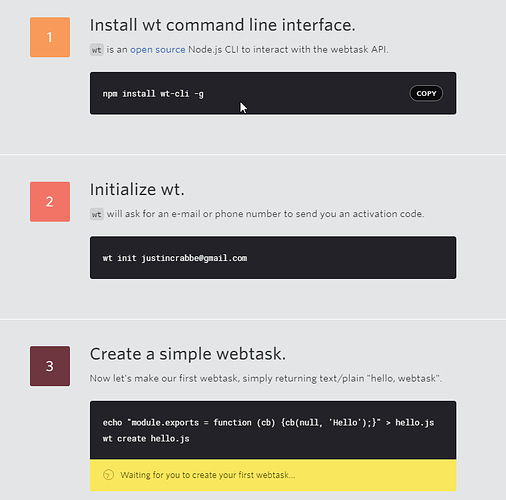

I may be going crazy or something, but I can’t find any web editor anywhere.
In the getting started docs it says “The recommended way of using webtask is through the wtcommand line interface. Install the CLI”
Is this the correct website?
Yes, it is well hidden. No idea why they do this !
https://webtask.io/cli
And then down the bottom you will see …
So … it is like those “funny” tests that teachers set that have 1. Read all the steps 2. Draw an elephant, 3. Make a noise like a motorboat … 25. If you have read this far sit quietly.
That will open the editor. Bottom left is …
“Webtasks” takes you to the list of all your webtasks (they don’t mention this, took me ages to find)… The URL is your API.
Top right is where you save your code, and then run it. The “Runner” it is like Postman or the Bubble API connector.
On my end, I browse the link, I only get to point #3 and i see you have a point #4.
This is the most bizarre thing I’ve seen a company do yet…
Thought I would add to this thread to help out anyone else looking.
Here is the editor and response from support.
Hi Justin
There are a few different ways.
One you can use our cli (https://webtask.io/docs/wt-cli), wt edit will open the editor. You can read about it in the linked page.
You can also use the make url, https://webtask.io/make will bring you into the editor to create a new task. This is not currently listed anywhere. We are doing an overhaul of our docs and it will be there.
Thanks!
Glenn
