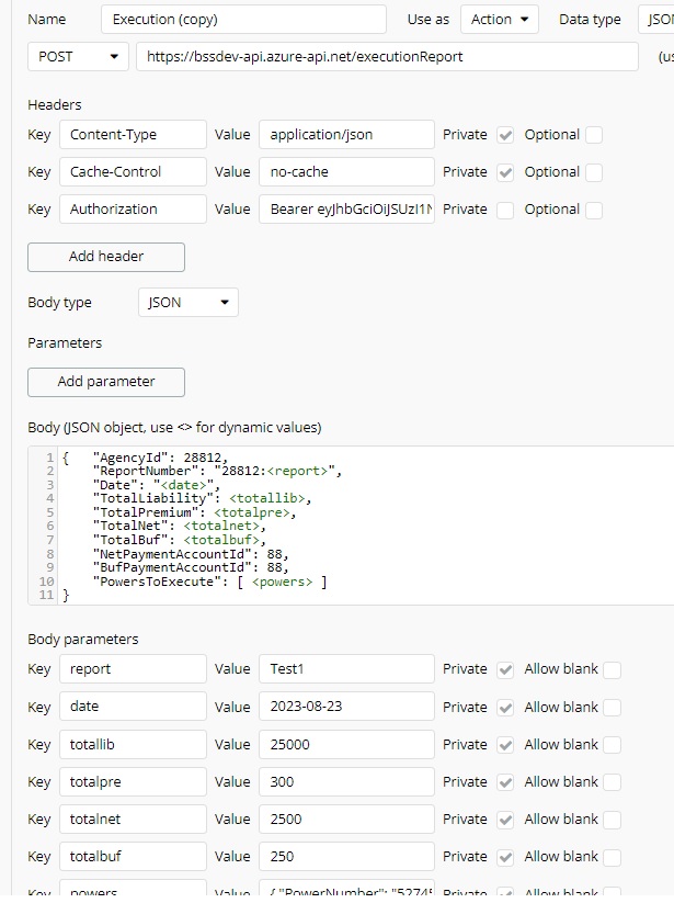

The screenshot of the API Connector shows all params as private, this means the workflow won’t be able to pass other values, I assume it is not the right screenshot?
Can you show the API call in the workflow where it uses JSONsafe?
JSONsafe for a text param puts "double quotes" around what it is passed, which would be an issue for the partial report number.
Can you show the matching mangled output and the API connector setup and the workflow API call?
Yea, that’s the wrong screen shot. But this is what’s currently going on.
Here is the call
Here is the workflow
This is the error:
“{“type”:“https://tools.ietf.org/html/rfc7231#section-6.5.1",“title”:"One or more validation errors occurred.”,“status”:400,“traceId”:“00-2cb2123e057d39fed99a63e053d6631e-dfd4f9add821b594-01”,“errors”:{”$.PowersToExecute[0]":[“The JSON value could not be converted to BSMS.Model.Library.PowerExecutionReport.Request.PowerToExecute. Path: $.PowersToExecute[0] | LineNumber: 10 | BytePositionInLine: 262.”]}}"

Also, if I copy line 10, and paste it directly into the "PowersToExecute variable, and click initialize, we get it to work. Yet, the two outputs are slightly different in that, the json is serialized different, and Bubble adds a baggage header when passed through the initializer but not through plugin when being passed.
I sent the wrong screenshot of the current call again. I have tried so many different ones.
This is the current one

Change the API URL in the API connector to a link at https://requestcatcher.com/ so you can see the raw body that’s being sent by Bubble to help debug. Run the raw body through a JSON validator to locate any issues.
The validator sees PowersToExecute as an array of text, which is “valid” but you want an array of object.
The problem is API connector treating the entire parameter as one text and escaping it, so instead of a structured object it is all text.
Not sure the solution …
Edit - since you want to pass a list of objects, perhaps change the API Body type to Raw, then do all the formatting yourself instead of JSON params.
