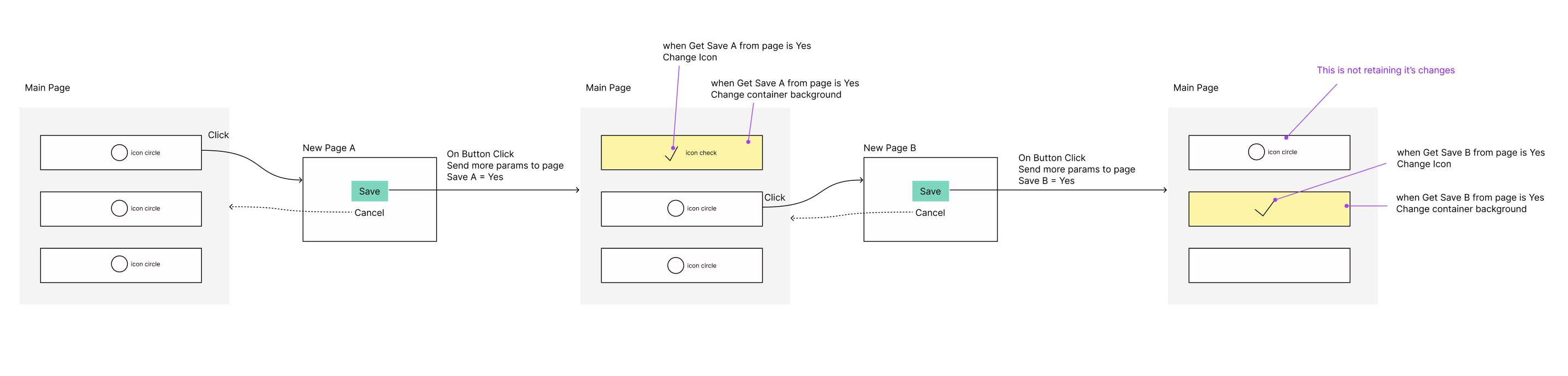

I’m trying to change a look or a component based on the action from another page.
I managed to utilize Get URL parameters, and things are working fine. But, when the page reloads, the component change resets.
Is there are way to keep the component stay in it’s last modified state, no matter if the page reloads?
Here is the diagram of what I’m trying to achieve. When I go to a different page and click Save and come back to Main Page, the previously changed element is not keeping its “Checkmark” status.
These are a list of tasks. When a task is completed in a new page, user comes back to the main page and that component is checked.
I don’t want this be linear - user can complete the tasks in any order they choose.

Here’s what’s currently happening
