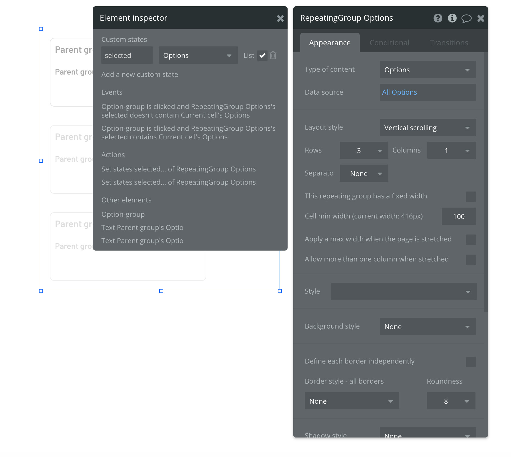

You’ll need a workflows to add and remove things from the state when users click on the options.
  • Create one workflow that takes the option the user clicks on and adds (plus item) it to the ‘selected’ state. You can set the workflow to only trigger when the state doesn’t contain that option. This is done using the ‘set state’ action. Each time you’ll take the existing state as a starting place and then add or remove from that. (see screenshot below)
  • Copy/paste that workflow and flip it to the inverse. I.e. removes (minus item) the option from the state only when the state already contains that option.
Screenshot shows the workflow to remove, but it is just the inverse of the add :
To check if your workflows are working right you can add a text box on your screen fed with the “selected” state. This will help with any debugging.

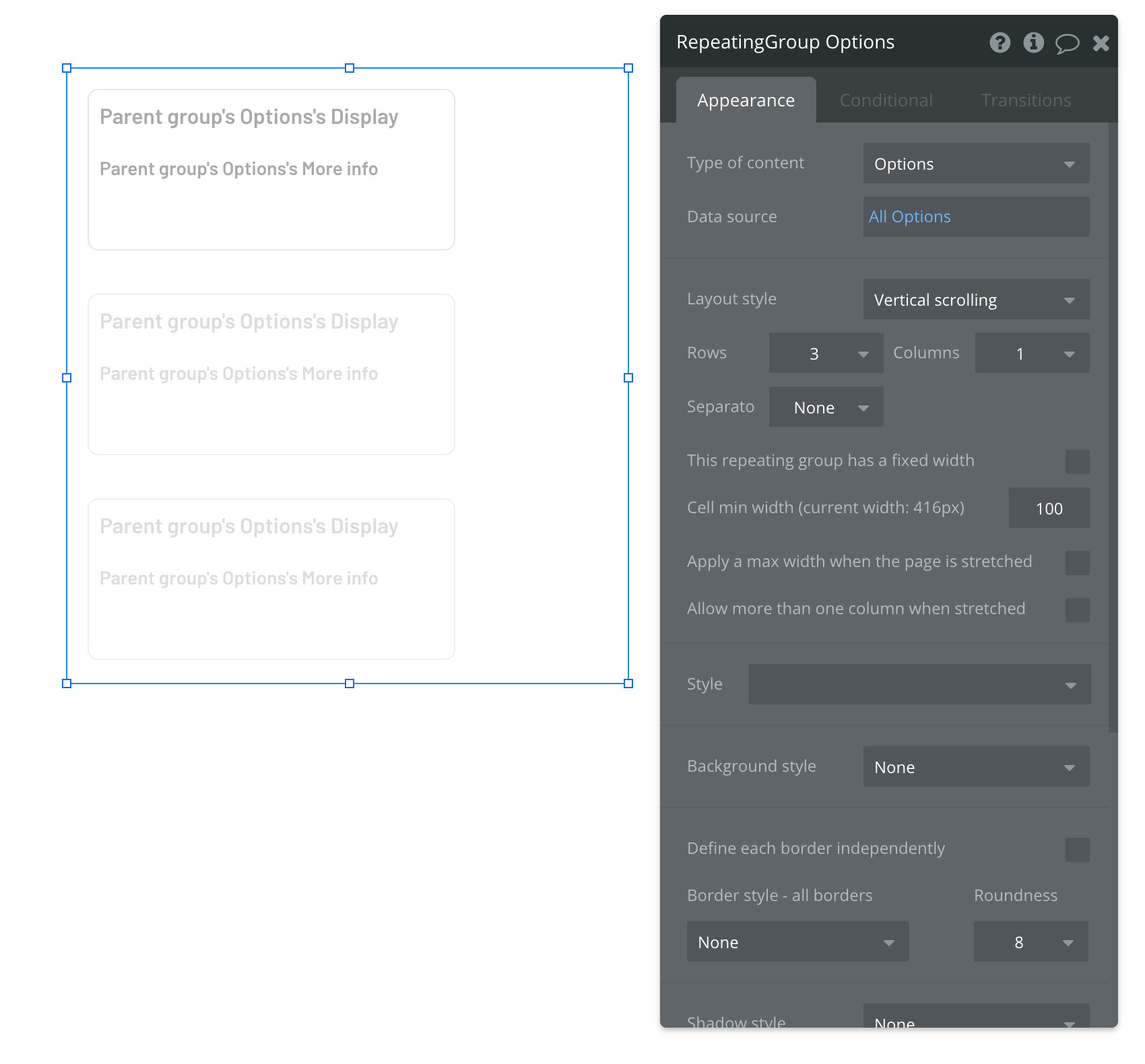

And here’s how it can look after the user clicks option 2:

Hi, there!
Adam i need some your help with this.
When i select RepeatingGroup Options’s selected (contains or doesn’t contains") Current cells’s Options
exacly when i select Contains, him show me a issue = Value should be List of Options but right now its is a yes / no
I did exacly you said in your tutorial.
Help me! Thanks
