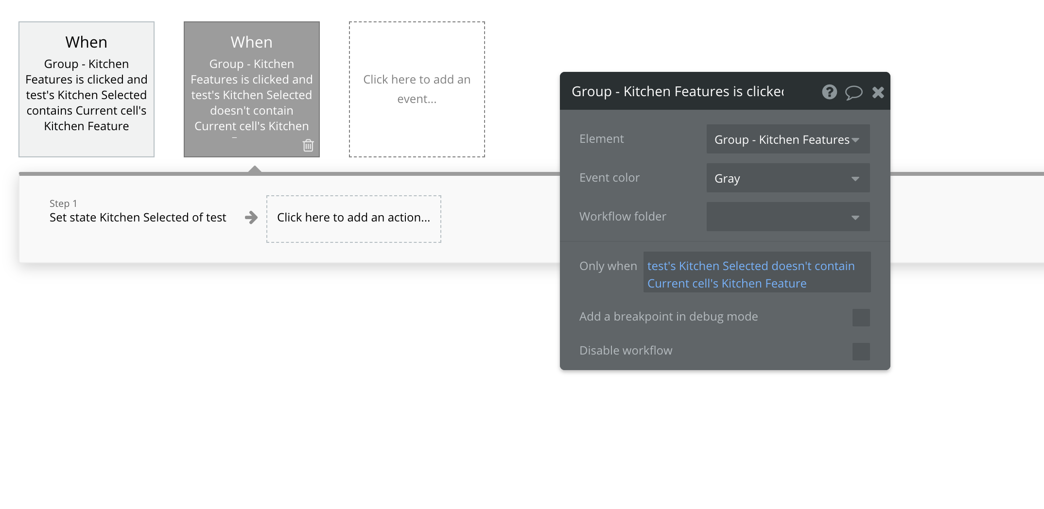

I have a simple repeating group with a group inside the repeating group cell, with text inside the group. When the group inside the repeating group cell is clicked, I’ve used a custom state and used conditionals to change the color of the group to reflect when it’s been changed or not. I’ve gotten this scenario to work.
The issue I’m having is the ability to select/deselect multiple cells with the use of custom states.
I’ve been trying to use the plus item feature, but I’m doing something wrong.
Here’s what I’m doing that works for selecting a single cell. How can I turn this exact scenario to where I can select multiple cells and the colors will change and go away upon what is clicked.
custom state should be a list of home type
when you click the text to add the type to the custom state list, you should reference as the value
“custom state home type value :plus item current cells home type”
your workflow action should have a conditional set
“when this current cells home type is not in custom state home type list”…use this as conditional on the workflow action to add the home type
to remove the home type from the custom state list
when click text to remove reference value
“custom state home type value :minus item current cells home type”
“when this current cells home type is in custom state home type list”…use this as conditional on the workflow action to remove the home type
