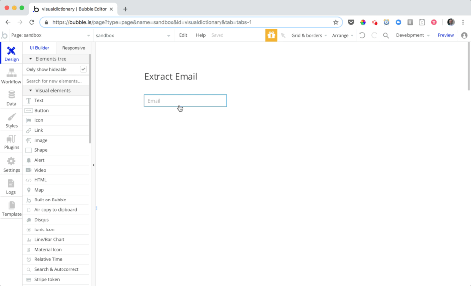

Your approach is on the right path. To round it out, you can use the “extract” function to get the top level domain. Then, apply your search based on that.

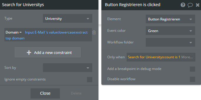

I have tried to set it up like this but the condition “Search for Universitys:count is 1” is never true, even if the input mail has a domain that is on the list.

I have attached the complete workflow.
Button “sign up”
Database
Whats not working?
Clicking on signup with the correct domain entered does not trigger the workflow.
It does not find the domain match (= the return count is 0).
Did I miss something?
Thanks in advance!
Try doing something without the “-” in the name. There’s a chance you’re mixing up em dashes and en dashes.
As well, if you have any privacy roles set, a user may not be able to see this data. (Since they are not logged in at this point). The domain name field would need to be publicly accessible / found in search.
Lastly, try clicking on somewhere else on the page first, then clicking on the button. It may be that the button hasn’t picked up on the condition.
Otherwise, that’s all that immediately comes to mind based on what you’ve provided.
@dan1 Privacy roles - that fixed it!
Thank you very much!
