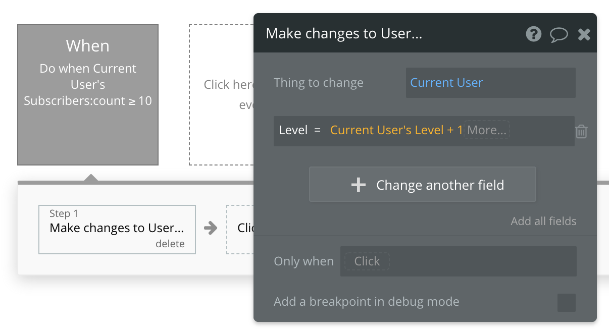

Hey there, this is certainly achievable through Bubble! You might want to set a field on the User data type that indicates what level the user is. For a simple example, you could set field “Level” type number and field “Subscribers” type list of Users to a User:
Then, you could tailor certain workflows to make a change to this user’s level based on the number of subscribers they have. In this example, I’ve used a conditional workflow that would level up the user when they hit 10 subscribers:
