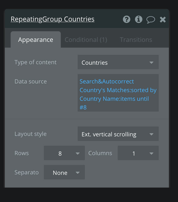

Upon further experimenting, I decided that the scrolling ability is not a necessity for such a potentially long list. I’ve attached the logic here to get the list, which is fixed at 8 rows and then to have the filtered results sorted alphabetically.
The user shouldn’t have to scroll at all to find their country of choice. They can just type in the first few letters and the alphabetical matches will populate (up to 8). If they type a 3rd or 4th letter they will undoubtedly find their result. No scrolling necessary. If there are less than 8 matches then the group collapses as expected.
I have a condition also set that resets the list if the Search Input is empty by changing the source of the list.
