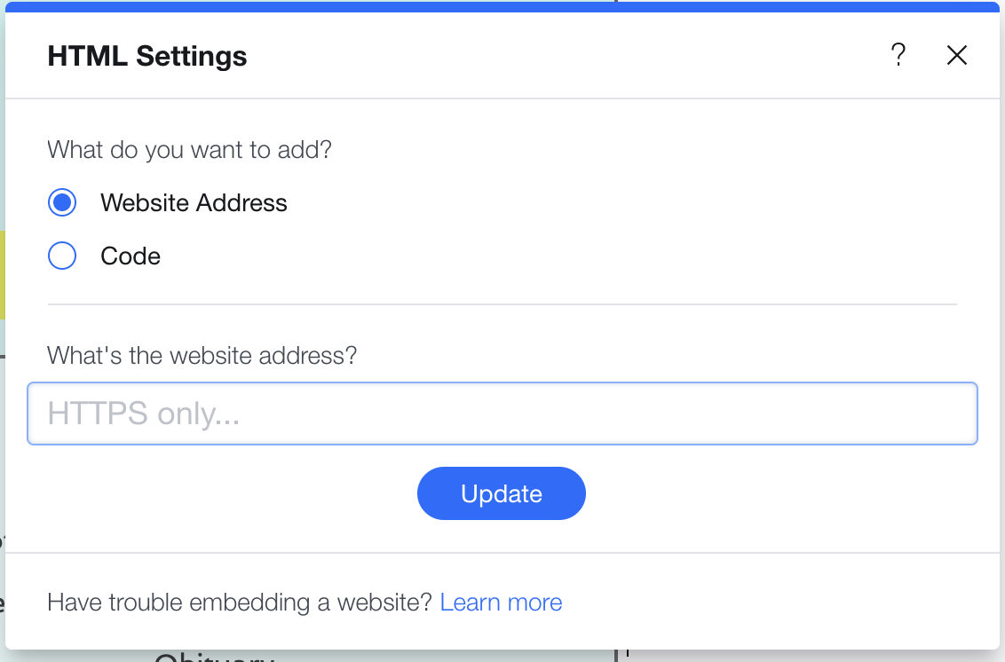

Thanks Andrew. I’m trying to get one of my Bubble app pages to show in a Wix iframe. It’s asking me for either a website address or code. Do I need to use a Live website address? Or how do I determine which code to use?
@meredith Sure thing! In your case, I’d lean towards recommending the website address and you’ll put in the address of the page you’d like to embed. I’m not familiar with Wix though to know if they give controls for width / scrolling etc if you just input a URL. If they don’t, you could use an online server to help build the HTML code for your own embed (where you could specify those things) and then input the code instead of just the url.
