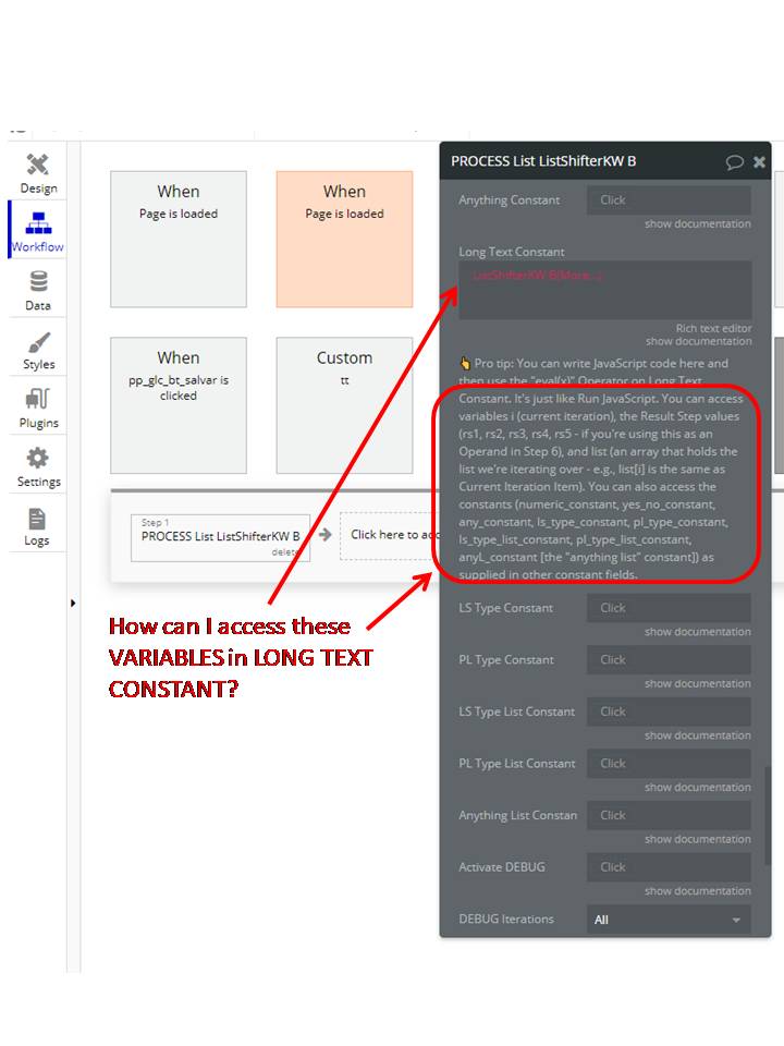

Hi @keith!
Sorry to bore you with this subject again.
I already searched at the forum.
I already asked other people at the forum.
I already saw your videos.
And I already tried a lot.
But, without success.
The reason to insist on this is that I have List Shifter in other modules in my app. And if I can not use this resource (Run JavaScript) with List Shifter I will have to redesign the app to use other plugins. Which is the last option for me.
So… could you please share some examples of how to use ListShifter with “eval(x) aka Run Javascript”?
My issues:
1- The variables you mention on “Documents Pro Tip” do not show for me.
2- The variable available is Original and Shifted List but they do not iterate over the list.
