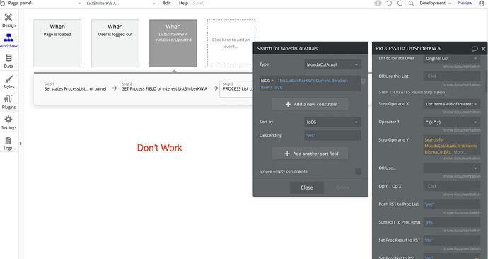

Why does List Shifter work when I use “List Shifter Iterator” but not when I try to do the same with “PROCESS List”? Am I doing something wrong? Maybe a bug? @keith
