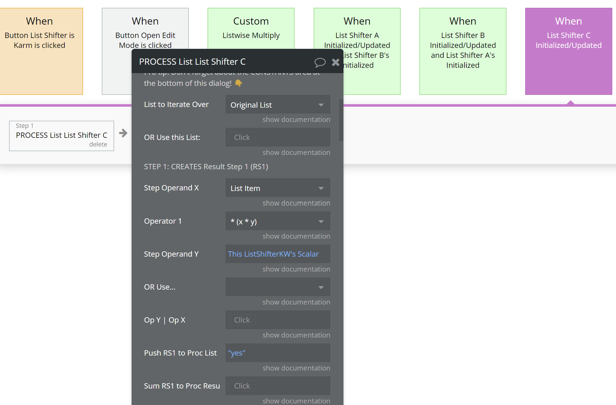

Anyway, having your API response (stored in a custom state or in a List Shifter - let’s call it LS API), you can have additional List Shifters that hold the decomposed values. That is, a List Shifter of type text to hold usernames (set its source to be something like LS API's Original List's each items username) . And similarly you can have List Shifters of type number (let’s call them List Shifter A and List Shifter B) for a and b – set their sources like LS API's Original List's each item's a / LS API's Original List's each item's b.
And then to compute your a*b, you would use the PROCESS List action. You can trigger that action when List Shifter B is initialized/updated. You’d set that up like this:
What this says is, "for each item in List Shifter B, multiply it by the corresponding Item in “LS Type List Constant”. And we push each computed value on to the Processed List by setting this option:
LS Type List Constant is provided by a field in the PROCESS List dialog, which appears way down at the bottom. (“LS Type List” means, “a list of the same type as this List Shifter”).
You’d set that up as being List Shifter A’s Original List, like so:
And so when this runs, List Shifter B’s Processed List now contains the results of a*b.
We could further set up another List Shifter to compute each item a*b times some constant c. The smart way to do this is to create a List Shifter C which takes List B’s Processed List as its list source (“List to Shift”), and imports the constant C via the Use Scalar input:
Such a List Shifter will Initialize/Update whenever either value changes. So we can set up a PROCESS List action on List Shifter C that fires whenever it updates, like so:
And when this runs, List Shifter C’s Processed List will contain the values of a*b*c. (And it will automagically recompute should the list of a*b or constant c change.

Hey @underhill.dan, yes, this is what the “Push/Sum/Set Only If” option is for in PROCESSED List Step 2 and higher.
Note that the results of any Step in List Shifter can be of various types and booleans are one of those. So, you can have a step that does an evaluation and the result of that step will be true or false. (Note that the results of a step don’t have to be scalars, but can also be arrays.)
Then, in a subsequent step, you can refer to that boolean evaluation and use it to say “do the push/sum/set part of the step only if RSx” which means “do the push/sum/set only if RSx is true”.
So, building on my original listwise multiplication example, here’s a simple variation where we only push the multiplied result to the Processed List if that result is greater than 50. We use 3 steps, like this:
Step 1:
Multiply “a” times “b”. Note that we do not immediately push the value to the processed list, it just stays available to us as RS1 (“Result of Step 1”):
Step 2:
Evaluate RS1 > 50. This will create RS2, which will be true if RS1 is greater than 50, or false if RS1 is less than 50:
Step 3:
Push RS1 to Processed List only if RS2 is true. Here, we refer back to Result of Step 1 (when there is no Operator, what we are saying is “just get me this value”). RS3 is now the same value as RS1. And now we set “Push RS3 to Processed List” to yes, but then we add the caveat, only do this if Result of Step 2 is true:
Example: https://list-shifter-demo.bubbleapps.io/version-test/only_if_feature?debug_mode=true
