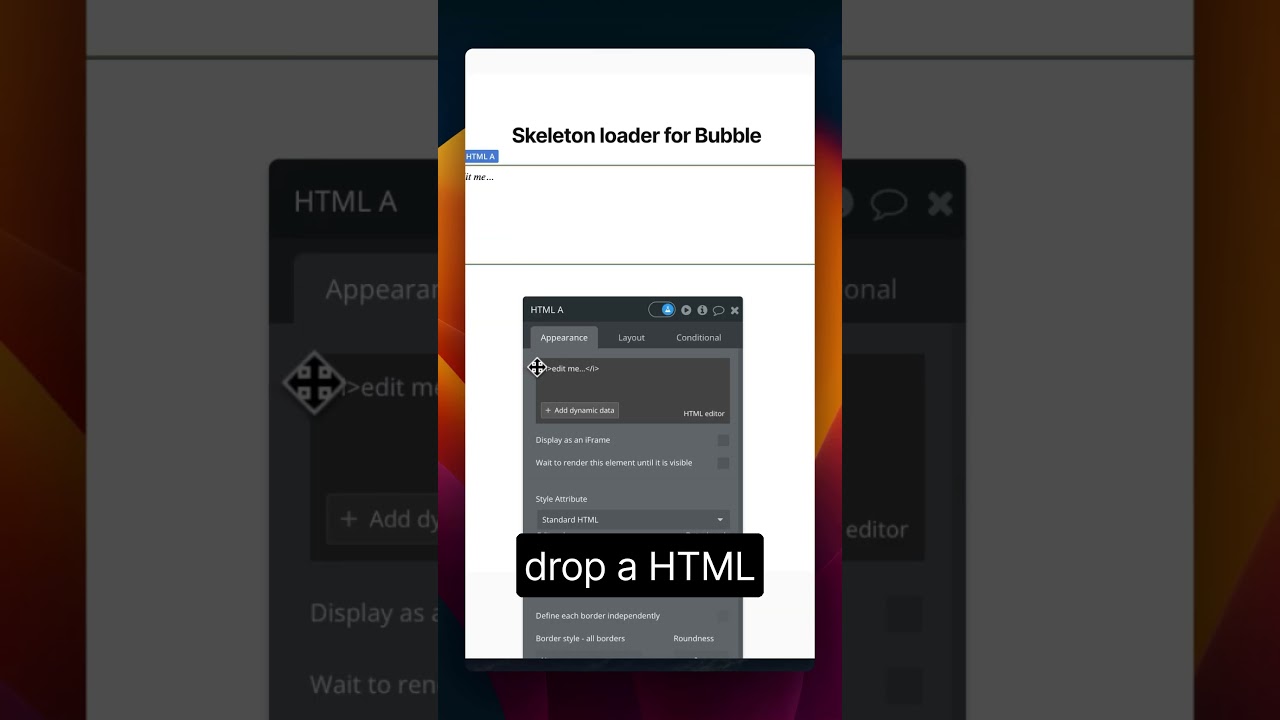

An example of a greyed out loading page I like:
You’re looking to create a Skeleton Loader! Here’s a short from @gregoryjohn on how you can do that:
Dude this is dope and you nailed it! Thanks for clarifying the language as I didn’t know the term. Now I’ve just got to figure out if I can ask Bubble if all the info in a group “is loaded” or if that is just for repeating groups.
