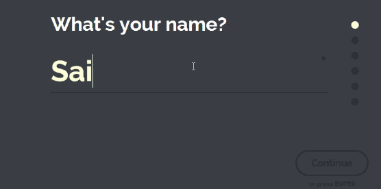

I’m looking for some input on inputs (lol…). We have a lot of information that has to come in all at once.
We tried using typeform, but due to the nature of their API/webhooks, it really doesn’t work well for this product specifically.
We tried building a typeform clone in bubble but the workspace just got waaaay too crowded and made it difficult to ever add more questions / make modifications in the future.
Lastly, we tried putting all the questions into the database itself for a dynamic, single repeating list, but the input fields change frequently (short text, long text, multi-choice, multi-select, Y/N, currency, etc.) and couldn’t determine how to make an input dynamically change based on the question.
Does anyone have any ideas that could solve this?
We’re next looking at doing something like this (below) but couldn’t figure out how best to approach it using Bubble that wouldn’t just cause us to run into the same problems.
Or perhaps this:
Or even this one:
Any INPUT appreciated, lol…
Have you considered giving the question a type field? You could then build your repeating group with each different type of input added and hide/show the inputs with conditionals based on the ‘type’ of question. You would need to put each input into a group so you can collapse its height when it isn’t visible.
Would take some logic on the Continue button to make it work properly but it should be able to be done.
