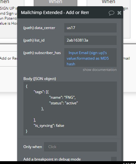

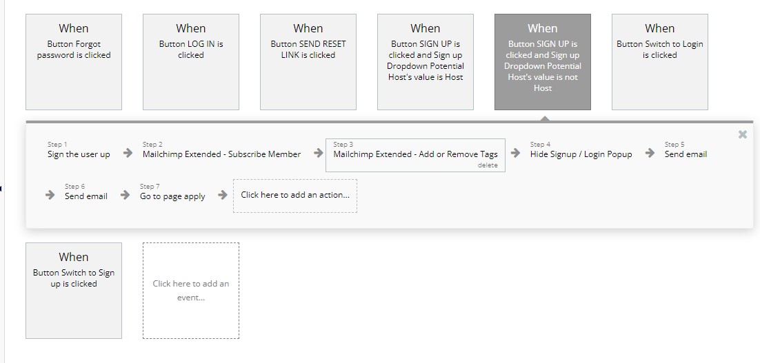

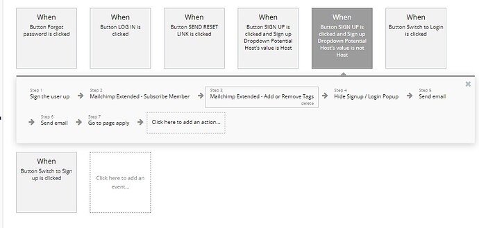

I need to see a screenshot of the actual set up of that workflow step, the same as your screenshot above.

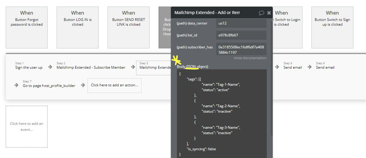

The JSON is is that set up

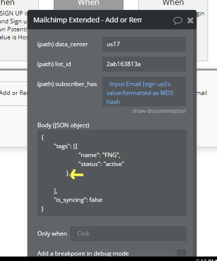

Take out that comma…that’s telling it the list isn’t finished but it’s the only/last one.

This is why I always validate all my JSON through JSON lint
Unfortunately I dont have a disposable email at the moment but it looks like it worked!
what does validate do in this case

It makes sure your JSON is structured in the right way (i.e. commas not where they shouldn’t be)…would have picked up this error for you.
