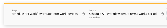

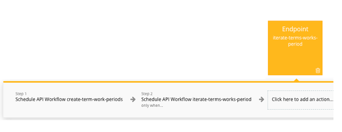

  • I have create the “top loop” (iterate-terms-works-periods) that looks like this :
From my understanding, in the “top loop”, the endpoints are executed asynchronously.
I’m looking for a way to start the next iteration in the “top loop” after the one before
I am looking for a way to make the next iteration of “top loop” waits until the one before is finished.

Hello @boston85719
Actually, it’s a basic loop on a loop :
For each X { (iterate-terms-works-periods)
For each Y { (ceate-terms-work-periods)
Since the only way to iterate in bubble is through API endpoints, the “iterate-terms-works-periods” is API Endpoint that calls “ceate-terms-work-periods” “X” times. The problem I have is that they run simultaneously.
Thanks in advance,
Yes, I’ve seen this screen shot before, but not the screen shots that would help understand how everything is set up

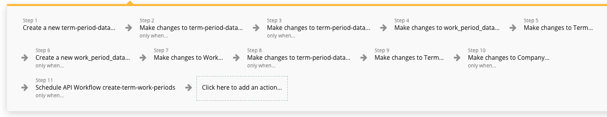

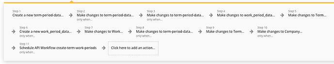

Where is that? and what is the set up?
Here it is.
In step 2 I would like to put a condition on the previous run, but since they all run at the same time it makes no sense .
