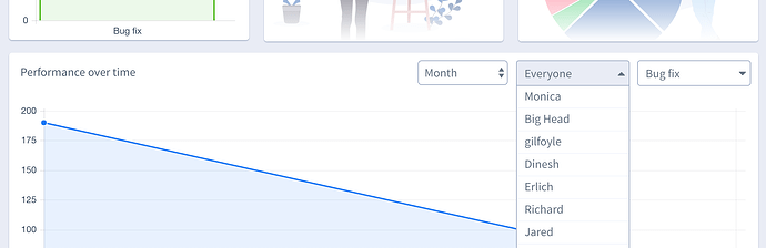

I have a GroupFocus that contains a RepeatingGroup. The list of things the RepeatingGroup displays is potentially very long. Therefore, in some cases, the FocusGroup height becomes greater than the page height and the content becomes inaccessible…
The expected behavior would be for the max height of the FocusGroup to be from the anchor point to the bottom of the page, and then the content would be scrollable, like a page itself (e.g. Trello’s Boards drop-down menu).

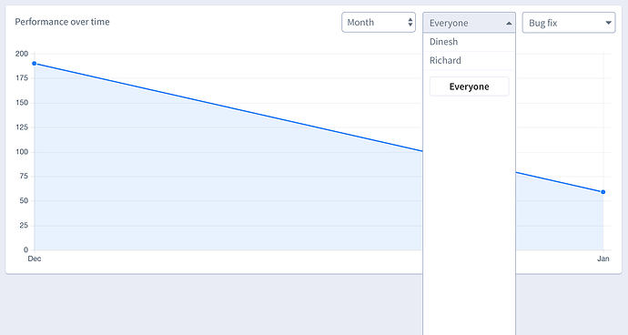

What kind of visual result is it doing for you @Kfawcett ? It doesn’t work for me, or at least it’s not achieving what I’m looking for (cf. my initial post)… :pensive:
It’s even unnecessarily expanding the height of the floating group, and it’s still longer than the page height.

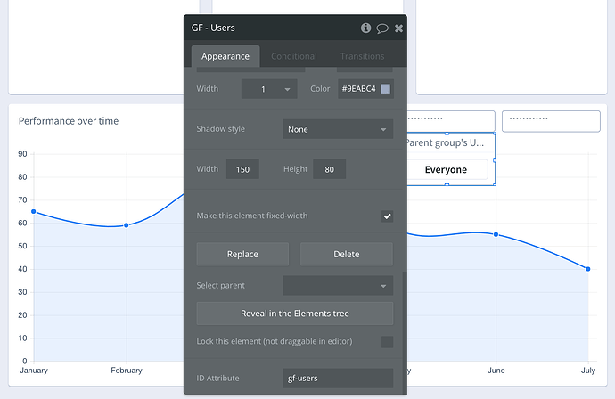

I’m doing something else in mine to set the width of the GF based on the right edge of an element on the screen. See the highlighted text in the screenshot.

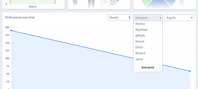

Here’s a demo showing the Group Focus where the height is only as large as the browser window, displaying a vertical scroll bar, and the width going to the edge of an element I defined.

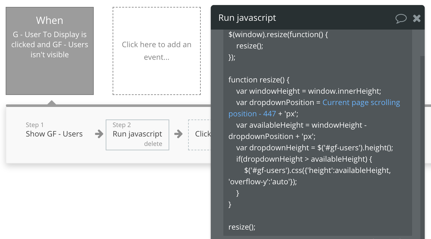

The tentative code below is probably more explicit to describe what I’m trying to achieve:
$(window).resize(function() {
    resize();
function resize() {
    var windowHeight = window.innerHeight;
    var dropdownPosition = Current page scrolling position - 447 + 'px';
    var availableHeight = windowHeight - dropdownPosition + 'px';
    var dropdownHeight = $('#gf-users').height();
    if(dropdownHeight > availableHeight) {
        $('#gf-users').css({'height':availableHeight, 'overflow-y':'auto'});
resize();
I’m not sure if my way of retrieving the vertical position is incorrect or if I have some other syntax/logic issue :thinking:

I still have to tweak that code a bit more though, as it seems that it’s not working consistently the first time around when the FG is displayed, but only the second time.
