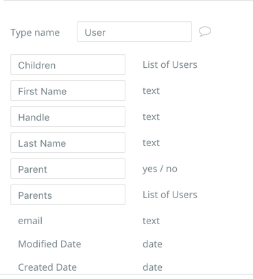

Hey @katcabin-bubble :slight_smile: I think the best way to structure this would be to make parents and children both Users. The benefit of this is also if you were to have a repeating group of a family, you can use a repeating group of users.
The way I would set it up is in this way:
The field ‘Parent’ is a yes/no field. If the user is a parent, the value is yes. If the user is a child, the value is no.
Then you can assign some sort of unique handle or username to each parent. In my example, I have a mother named Sally Jones, whose handle is SallyJones14. Her son is named Bobby Jones and his handle is BobbyJones14.
So if Bobby is logged in, and needs to be added as a child to his mother Sally’s list of children, he would input her unique username and then click ‘Add Me As Child’:
When ‘Add Me As Child’ is clicked, this is what it looks like in the workflow (we are making changes to a User (With the User being Sally, and the field we’re making a change to is her List of Children).
This search will only result in one result as long as Sally is the only user with the handle SallyJones14.
After the workflow is completed, this is what Sally’s App Data looks like:
You could also add Sally to Bobby’s List of Parents in that same workflow:
Then Bobby’s App Data will look like this:

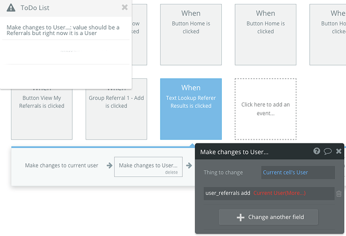

I can’t get my field to just add current user like the @fayewatson example shows . It wants me to add something else after Current User and it gives me an issue that “make changes to User…: value should be a Referrals but right now it is a User”
In this app, it is the same situation as a parent/child. In the user type, I have a field called user_referrals that is a “list of referrals”.
I cannot get the results of a search to add the current user to the user_referrals list of another user.
I used “make changes to a thing”
Either your user_referrals field should be type user if it’s actually a list of users… (You can then add a user in the way you’re attempting in the screenshot)
OR you add a referral, not a user, to the list. You’ve defined user_referrals as a list of referrals, so you need to add a referral. You’re adding a user which is why it’s red. Your referral could then contain a user field and any other relevant information, and you’ll still be able to access the user attached to the referral.
