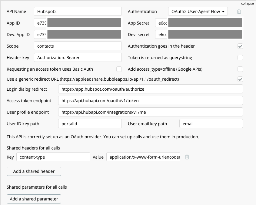

As @lottemint.md advised in this post, we decided to build a manual OAuth flow.
- Weāre successfully grabbing the āauthorization_codeā from the URL using the API Connector User-Agent Flow, with the following config:

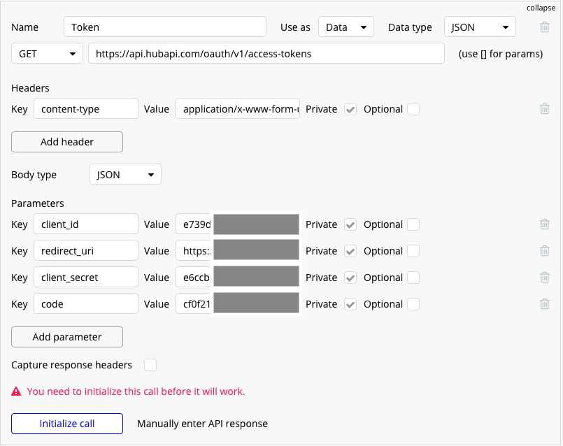

- Then, as instructions above (thanks @NigelG!), weāre using the GET /access-tokens to retrieve the generated token using the authorization_code:
Weāre getting this error when trying to initialize it:
Any idea why? Any advice would be helpful ![]()

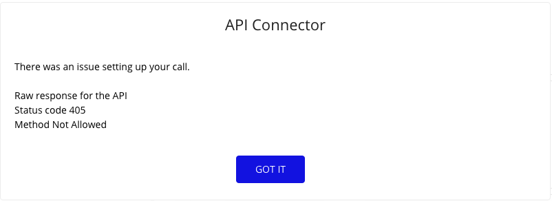

The clue is in the error
Use the POST method not the GET
Ah thanks @NigelG, I thought we needed to use a GET here as for the FB example above.

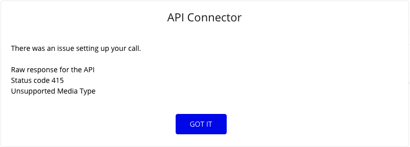

I tried that and now getting a different error
but I feel weāre almost there thanks to your help.
Config:

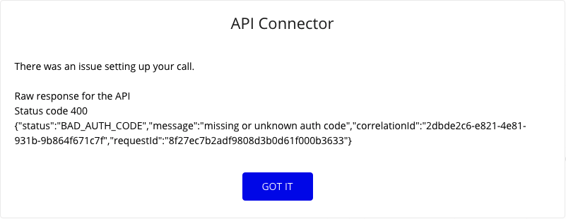

And the error:
According to some Hubspot forum posts, the config seems correct (and weāre obviously grabbing a new code for each initialization request we make).

@NigelG thanks! Iām going nuts. I did exactly as you did and still getting this Bad Auth Code error:
Did you set it the same way?

Thankfully @lottemint.md very kindly offered his help as well and walked me through all the steps on a test app. Works like a charm now!
In a few words: instead of going through the āUser-Agent flowā which I was desperately trying to use, we had to go through a āNone or self-handledā method.
