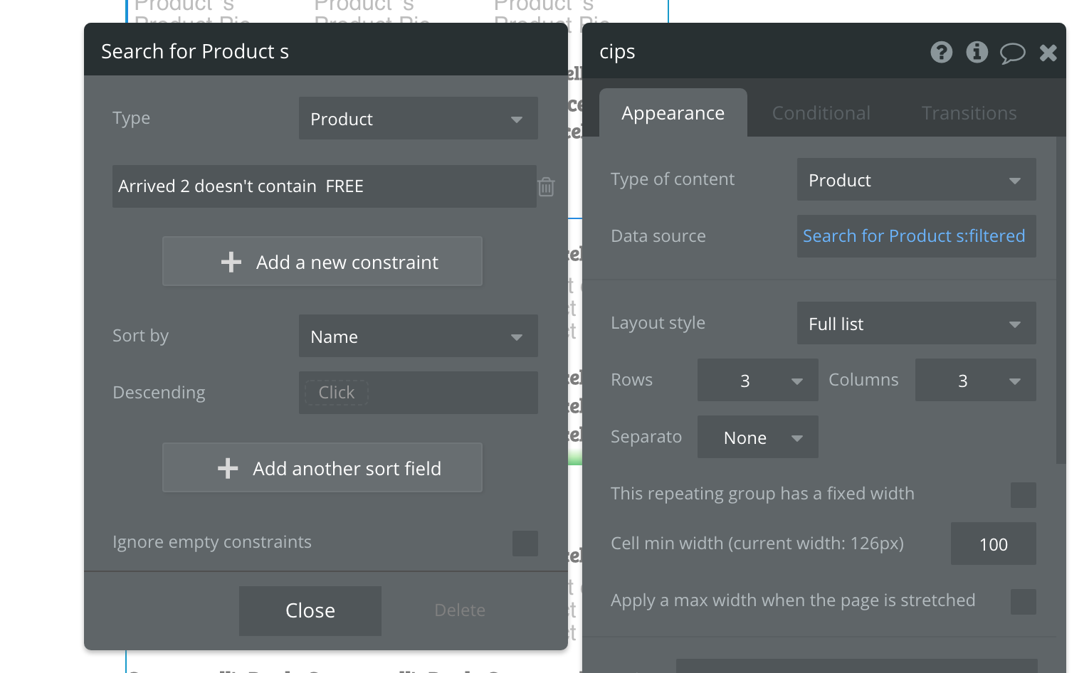

Hi @marsj3716 :slight_smile: This might not do the trick, but the “cips” repeating group currently uses this data source:
(1 constraint in the Search)

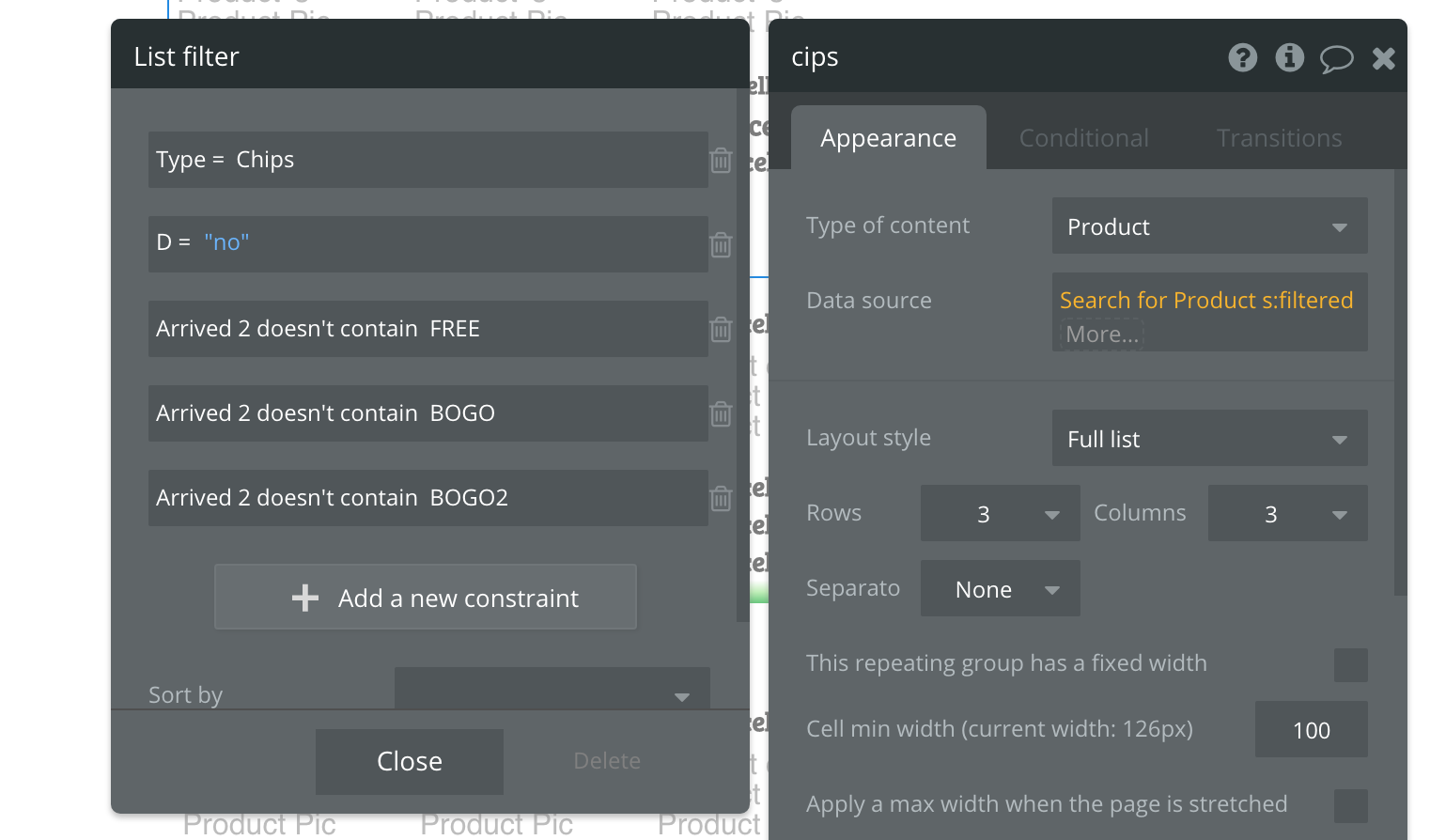

(5 filtered constraints)
Since those filtered constraints can be put into the “Do a Search For” part of the expression, I would recommend removing the :filtered part of the expression completely, and adding those as search constraints (so the expression is “Do a Search for Products with 5 constraints”).
This is because currently, Bubble is loading/bringing back all of the Products which meet the search constraint “Arrived 2 doesn’t contain FREE” in the “Do a Search for” part, and then 1-by-1 filtering all of the Products that don’t meet the five :filtered constraints here:
It should be faster if you move all of the constraints to the “Do a Search For” part of the expression in this case, but let me know if not! :slight_smile:

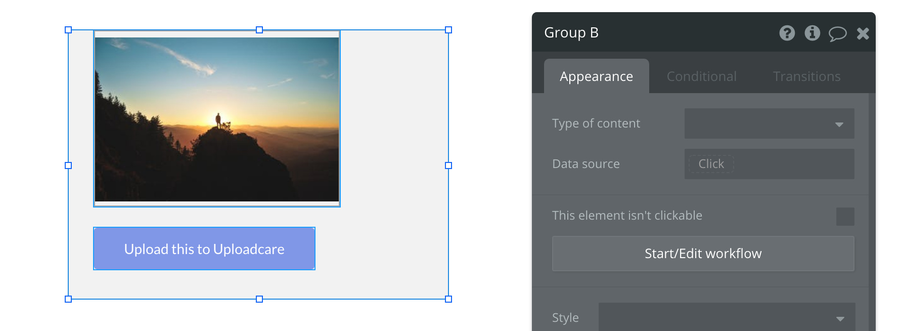

In summary, there are two custom states set on this page to keep track of the uploaded image’s “token” and “Upload_Info” from UploadCare, after an image is uploaded to UploadCare:
The first group contains a picture uploader and a button:

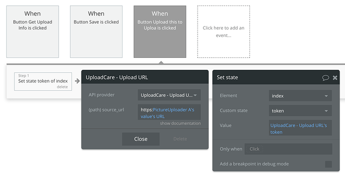

When the Upload this to Uploadcare button is clicked, the “token” custom state is set, and it uses the expression:
“Get Data From External API”
API: UploadCare - UploadURL
(path) source_url: Picture Uploader A’s value (the picture that was just uploaded)
*Be sure to select “UploadCare - Upload URL’s token” for the value of this custom state.

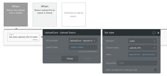

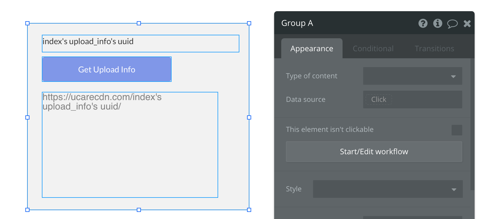

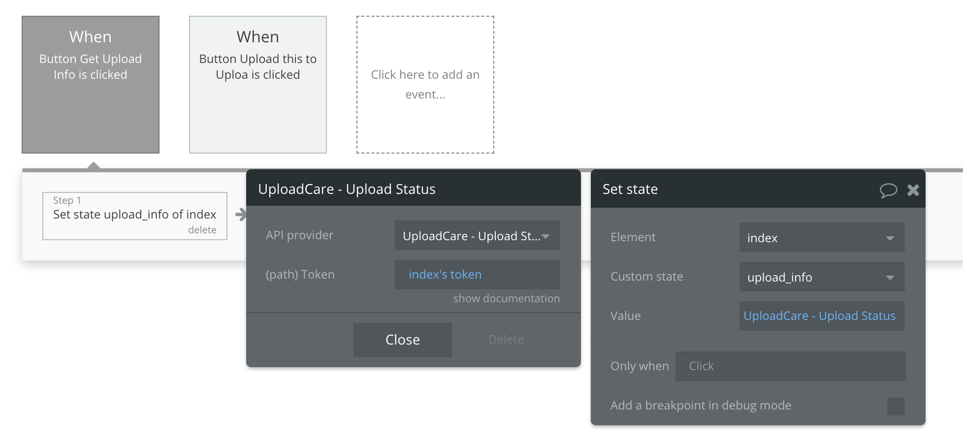

The second group contains the “Get Upload Info” button, which will display the information of the image that was uploaded to UploadCare in Group 1:
When the “Get Upload Info” button is clicked, the “Upload_Info” custom state is set using this expression:
API: UploadCare - Upload Status"
(path) Token: index’s token (the UploadCare image token that was saved to the index page’s “token” custom state in the first step)

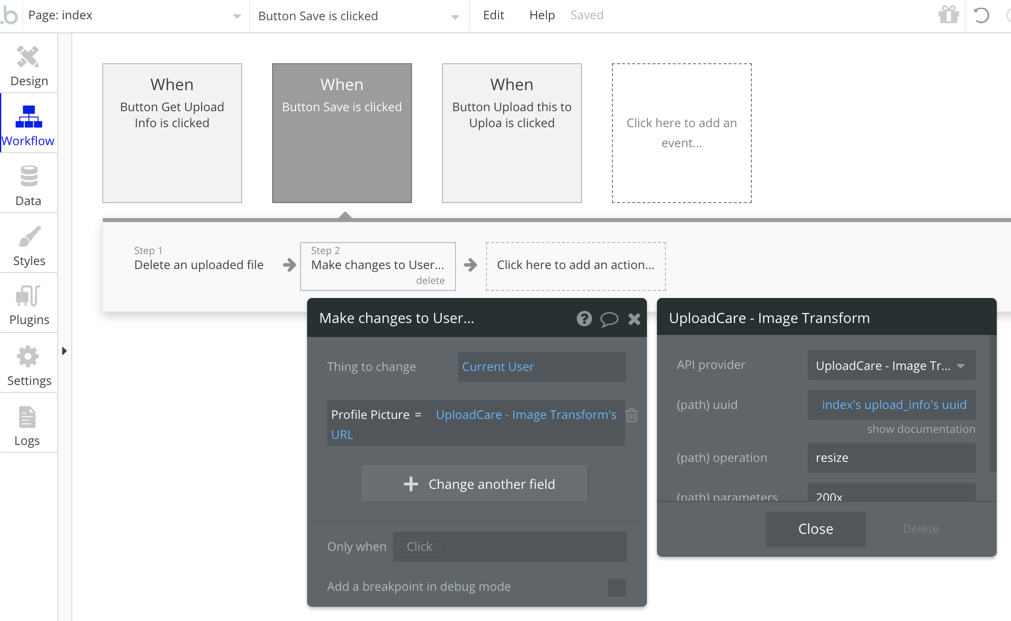

Once you’ve resized the image, you can delete the original, larger file from your app’s storage:
Then save the smaller, UploadCare image URL to the field you need:

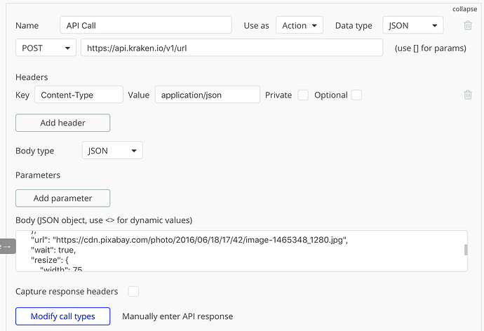

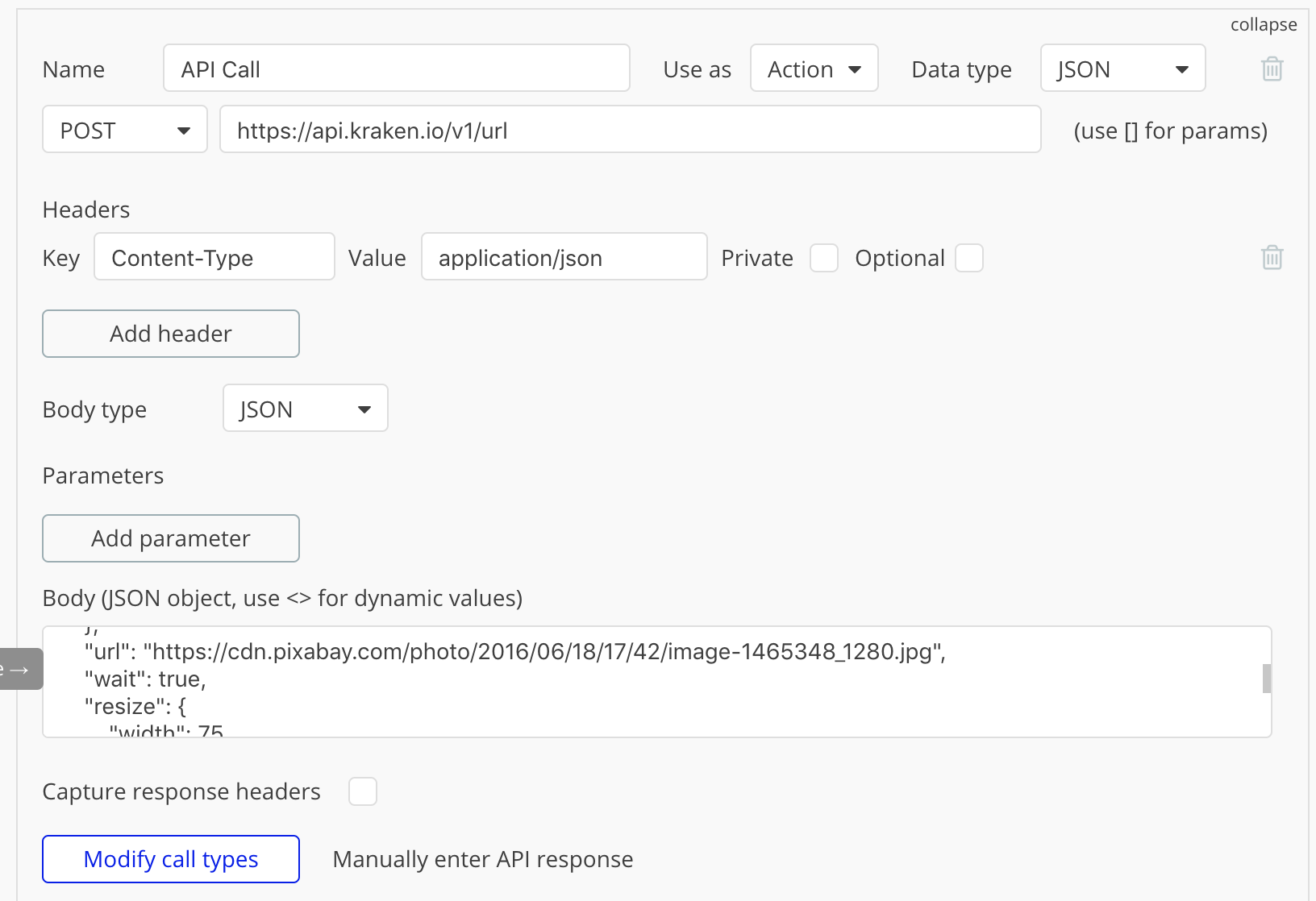

Both Kraken.io and Uploadcare sounds interesting. I saw that Kraken let you configured a callback free (faster). Call Kraken from API connector is relatively easy. Kraken interface sound more robuste. Illusion? :slight_smile: Setup time: 5 min.!
thanks @fayewatson for the demo explanation.
Kraken: We highly recommend use of the “callback_url” option over the “wait” option, as it eliminates the possibility of a request timeout occurring where large files are being Kraked.
EDIT: Kraken with Bubble API Connector is working fine. Great product. I compressed a 287k image to 4.3k in less than 1 second.
“auth”: {
“api_key”: “public key from Kraken”,
“api_secret”: “your private key from Kraken”
“url”: “https://cdn.pixabay.com/photo/2016/06/18/17/42/image-1465348_1280.jpg”,
“wait”: true,
“resize”: {
“width”: 75,
“height”: 75,
“strategy”: “auto”,
“enhance”: true
Here:
Result:
