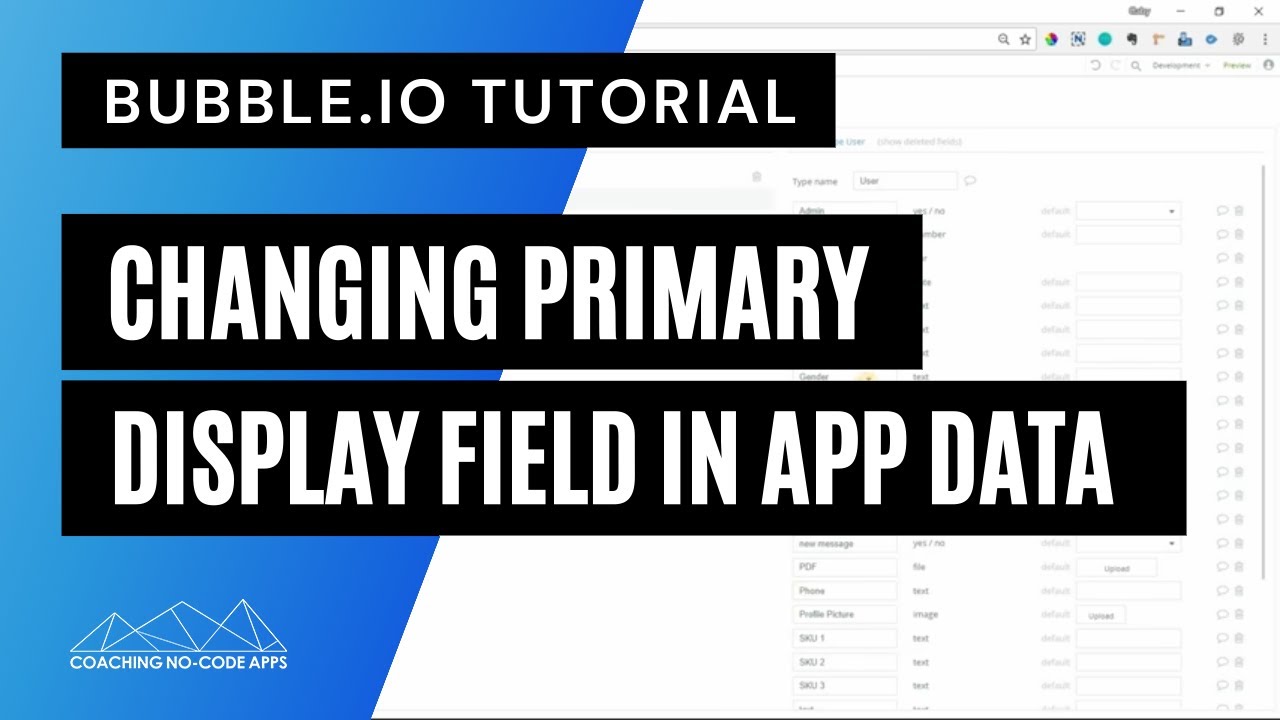

one question… when I look at the data in the table, it shows the tags as their uniqueID number, rather than anything English/readable. Is that what we would expect?
Thanks again
You have a related field and the “primary” field is set to unique ID by default. You can change this
