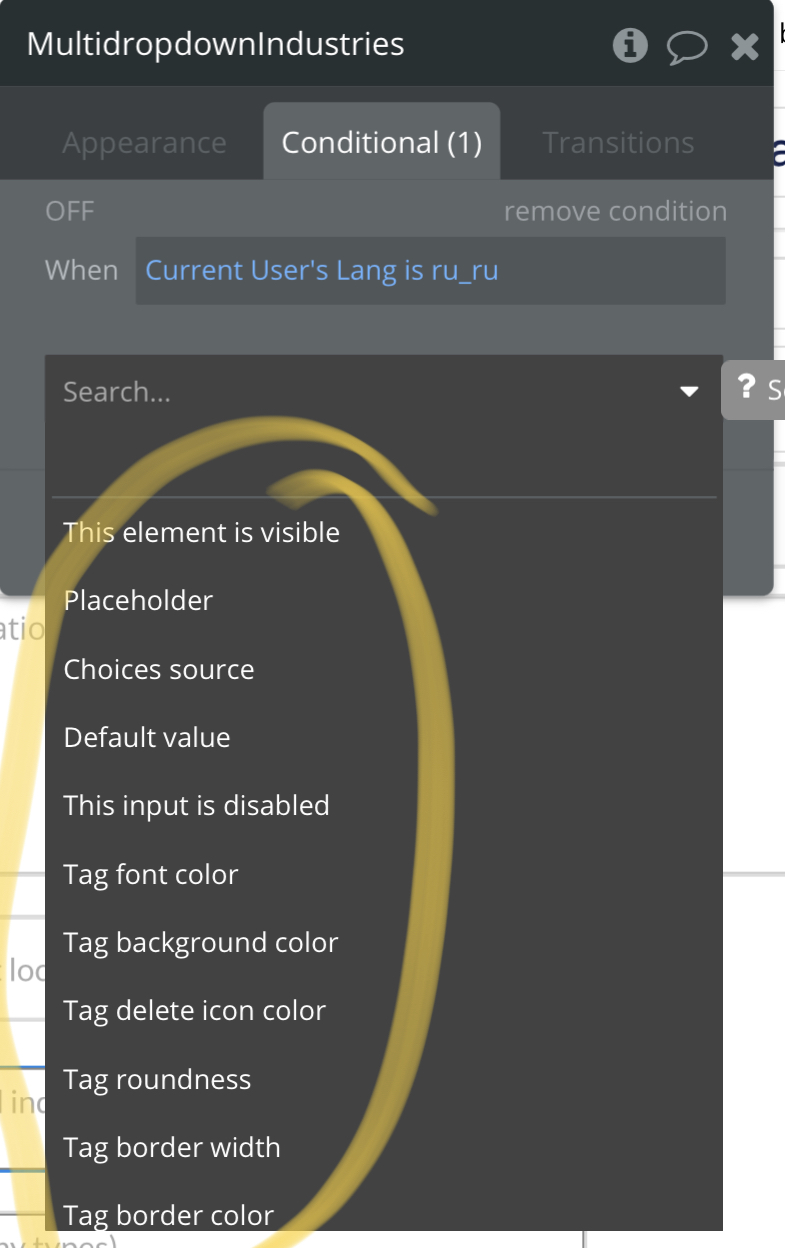

I am using Multiselect Dropdown by Bubble.
By default, option captions are English labels and it works.
The problem begins as I trying to change “Option caption” parameter via conditions tab - there is no such item in the list:
Do you know a way how to change “Option caption” parameter of “Multiselect Dropdown by Bubble” via condition ?

Little hack that worked for me. Create a condition with an option caption in a normal dropdown. Copy the condition and paste it in the multidropdown
Thank you!
This is fantastic! Didn’t know you could conditionals like that. I guess Bubble should get around to fixing this issue in general, but this fully solves my issue
3 years later, this is still the best solution. I’ve spent the entire afternoon finding a solution and this is the only thing that worked for me.
