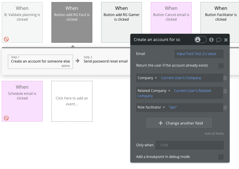

Hello everybody,
I don’t think I can’t do something that simple.
I created an account for another user with a reset password sent by email.
The user receives the email and changes their password.
This directs him to the log in page, and when he writes his email and password, it doesn’t work.
The error message is: “We did not find an account with those login credentials
And yet, there are email addresses in the User database.
There is a photo of the “create an account for someone else” below.
But why doesn’t it work?:exploding_head:
Thank you
Hi there, @thomascope… if the user receives the email and is able to reset their password, then your creation of an account for someone else appears to be working. Are you able to see the user in the User data type and have you tried using the Run as feature to see if you can run the app as that user? If that works, then it seems like the only thing left is that the user is typing their email and/or password incorrectly when they attempt to log in.
Best…
Mike

I think it works when I reset the password because when I click confirm, the app go to the page Log in. You can see on the image below. the debugger step-by-step:
what do you think ?
You don’t have a Reset password action in that workflow, so the password isn’t being changed… you are simply taking the user to the login page when the button is clicked. Did you make that form or are you using Bubble’s built-in reset password page?
I took the page that Bubble propose for the reset password. And below I took some screenshot on my workflow (I think after you see it, you will hate me ^^)
Screenshot 2023-12-30 at 20.32.40
Should I add ?
a step for reset password
and a reset for an update Update the user’s credentials
Thank you
This is what the workflow looks like on Bubble’s reset password page, so I guess you deleted the Reset password action? I don’t know why you would have done that, but that’s why it is not working.
