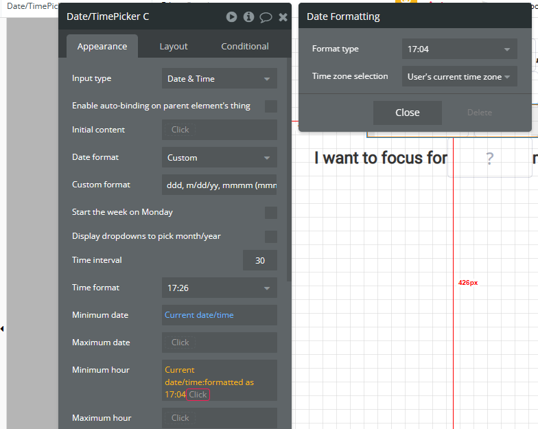

Hi, I am creating a time blocking app, so when a user sets a block of time, it should not be in the past.
  1. is there a way to use the time picker to do this? At the moment, I cannot get it to just show the time and I can’t work out how to restrict the time to the future.
  2. is there a plugin that will do this? I have tried Air date and time dropper
  3. how do I go about doing this? Is there a better way?
Thanks!

If, specifically, you’re talking about using a date/time picker, then just put the minimum date as the current date/time.

You can do exactly, as I said, that by setting the minimum date to the current date/time.
Ah, right, I see, the date thing worked, thanks!

I have tried to do this by not splitting the date/time picker, but it doesn’t seem to like that, or were you meaning something else?
You can see here that it doesn’t like me trying to put in a minimum hour…
Ah, also, when I remove the minimum hour constraint, I can see that the time picker intervals are every half hour, I definitely need to let my users select a specific time…
What do you mean by ‘a specific time’?
the minimum hour must be a number.
You’re putting a text.
You can set the time interval to anything you like in a date/time picker
The user will want to set the start time to whatever they want it, rather than be limited to the half hour that the time picker seems to let them.
I.e. Start session at 5:43pm but the picker only allows 5.30 or 6pm
Ah, seen, thanks!
then set the interval to 1 minute
